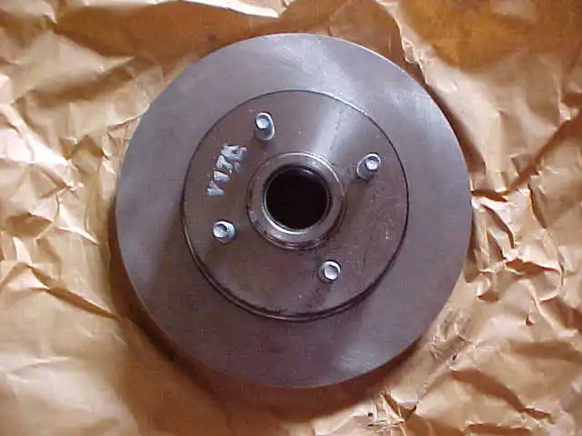

See the raised area where the lugs are?
That's the "rotor hat". The '93 Cobra ones won't fit under certain wheels due to their size.
mansonozz ... you are the man...and if i remember correctly...you have to have 17" wheels,which i do :)...so with that being said...would there be any difference in putting drilled & slotted gt rotors or cobra rotors?

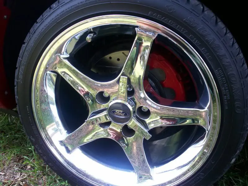

I once upgraded my stock '92 brakes to direct replacements that were drilled/slotted. I did it for looks. I noticed no difference. Some will say they noticed a difference but most urge not to buy them hoping for performance.
I've since upgraded to a 2001 Bullitt 5-lug/all-disc setup, and got the drilled/slotted rotors again. For looks, again.

Bigger brakes isn't necessarily a speeder's thing! Haha. Safety is another issue, and trust me - these SN95 brakes are a night and day difference over the stock ones. I didn't think I'd care about the difference but once I finally did it for performance and modification reasons, I was in love with them. I can't imagine going back to stock brakes.
But anyway, some caliper (and drum) paint, some aftermarket direct-replacement drilled (or dimpled)/slotted/zinc washed rotors, and you'll look a lot better. Then again, larger rotors up front and rotors out back always look 200% better than small rotors up front and drums in the back :)
