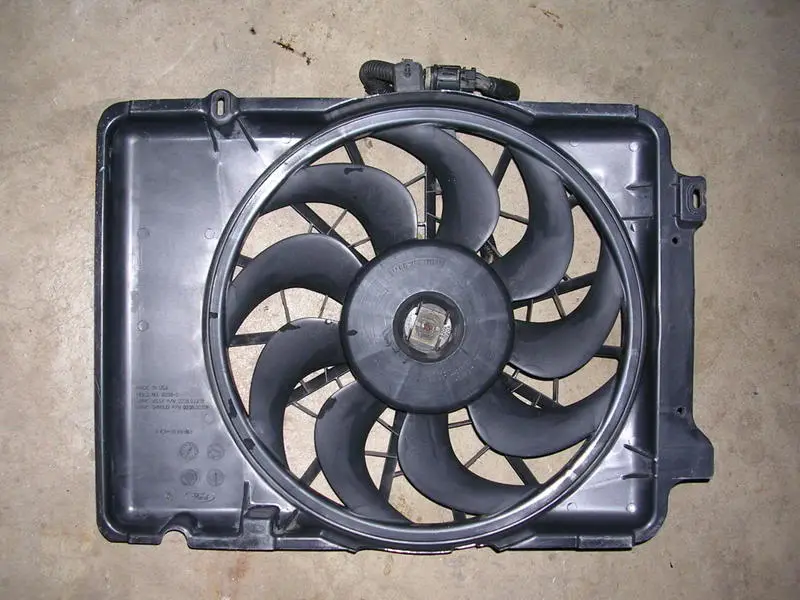

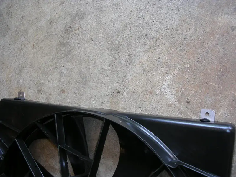

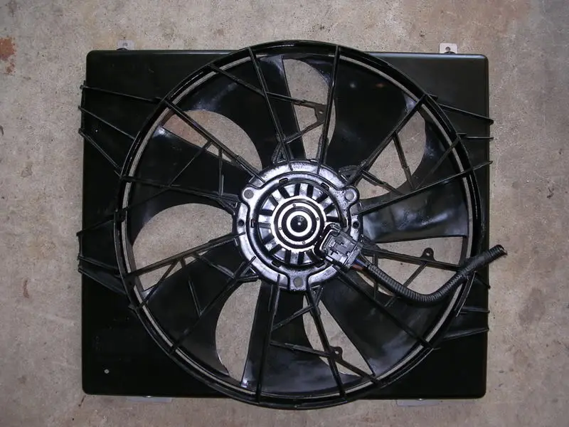

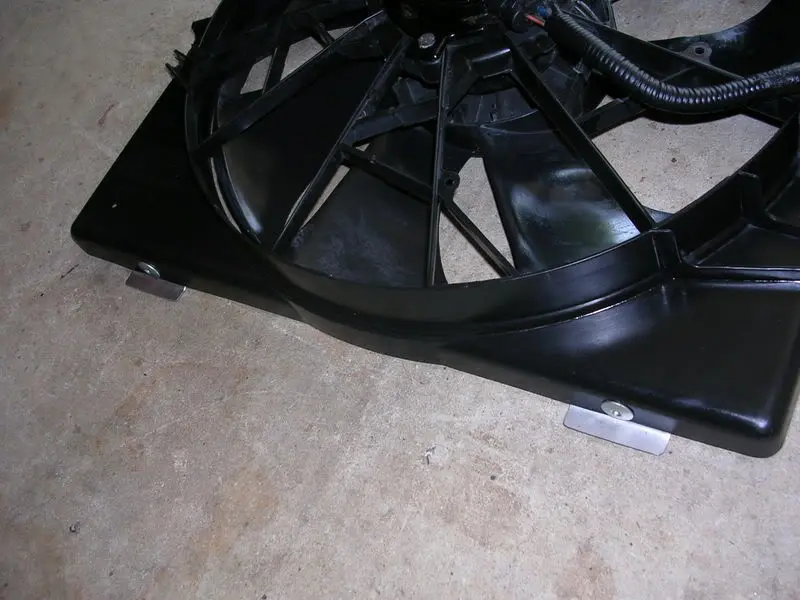

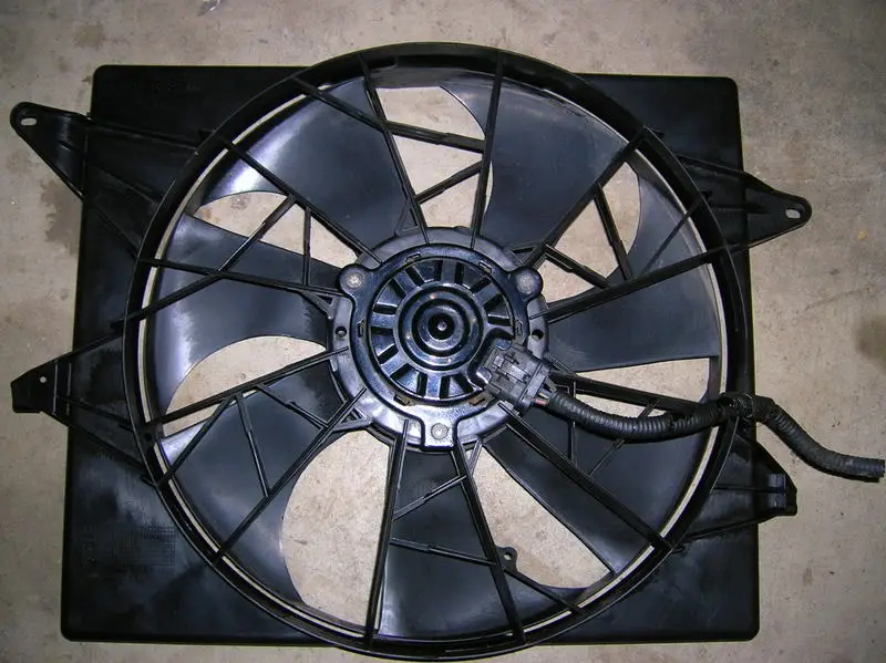

Here's some good info:
From the corral, you could do a search on that website, if you want:
Electric Fans! - Mark VIII, Tuarus, and Dual Ramcharger
Fan Info
Looking for an electric fan upgrade to install this summer to solve your overheating problems, ... Let me first say that I personally run one of these Mark VIII fans in my 1992 GT with a DCC and it works awesome and is in my opinion the best setup to go with. I have a buddy with a 700rwhp 03 Cobra that also runs one of my Mark VIII fans and it works awesome for him too. I have personally flow tested all 4 of these fan types to find out the actual CFM flow and the Mark VIII and Taurus (Taurus and Mark VIII fans have same motor) fans flow about 4500 CFM and some have done about 4900CFM. The older style Dual Ramcharger style fans flow about 3500-4000CFM and the newer Y2K Ramchargers flow about 3000-3500. All 4 fans are dual speed fans also.
.... fans unmodified, trimmed, or with custom stainless steel brackets to bolt right into a 5.0 (as long as you have the stock radiator or an aftermarket radiator with factory mounting points). For the Mark VIII fans with custom brackets, the J-clips at the bottom of the radiator need to be trimmed by .5", which is very simple and only takes some tin snips to do.
The Ramcharger style fans do not go all the way to the bottom of the radiator, so I suggest using some through-radiator ties to hold it flush against the radiator. I can setup the Ramcharger style fans with the brackets on either side of the fan so that the wiring can either be at the top or bottom, or on the older style Ramcharger changing bracket sides would make is that the taller fan motor can be either on the passenger side or drivers side. i.e. in the pictures below, the fan is setup so that the wiring is on the top and the taller fan motor is on the drivers side, but could be reversed
The Taurus fans ... do not sell with custom brackets because I find that most people prefer to use the through-radiator ties with it, though I do not recommend using those to fully mount and hold a fan to the radiator.
Fan Dimensions
- Mark VIII dimensions are 18.5 x 22 x 6 and 18" blades, not including the tabs.
- Mark VIII w/ trimmed tabs and trimmed depth dimensions are 18.5 x 22 x 5.25 and 18" blades
- Taurus fan dimensions are 18.5 x 23 x 5 inches, and 17" blades
- Y2K Dual Ramcharger style fan dimensions are 26 1/2 in wide by 15 1/4 in tall and a slim 3 5/8 in deep
- The older Dual Ramcharger style fan dimensions are 15 x 25 x 3 inches deep in the center and 4.5" at the small fan motor center and 5.75" at the tall motor. 13" fan blades.
OEM unmodified Mark VIII fan
Mark VIII w/ custom brackets for 5.0
Taurus fan
