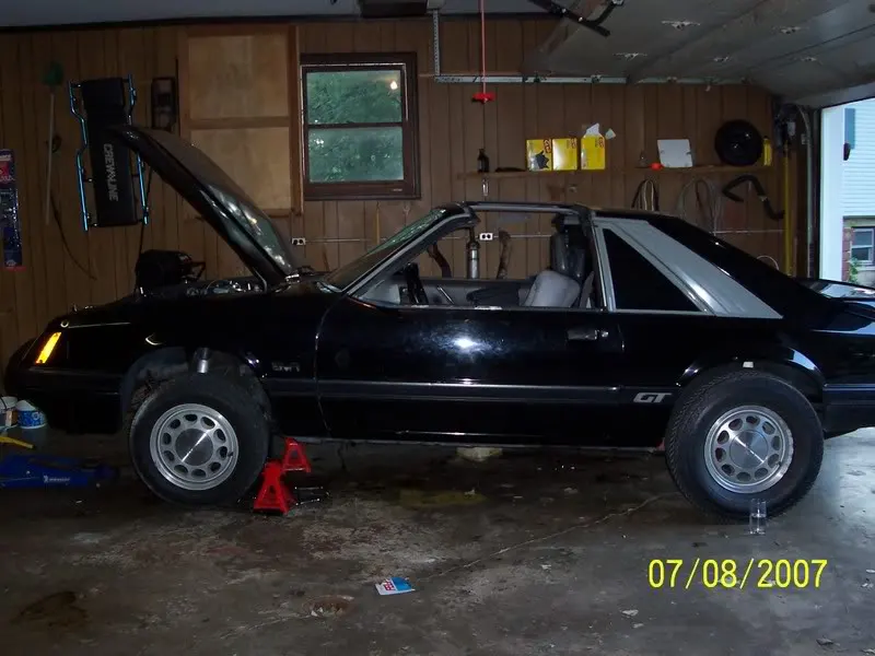

im runnin these currently. 28'' tall L60 MT indy profiles. no quad shocks and i had to massage the inner fenders a little so they wouldnt rub.
