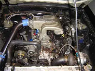

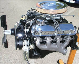

What's the diffrence bet a 1st Gen with an EFI 5.0 and a 289 with Projection+Ignitor?

The 5.0 would have a roller cam, and port tuned injection. The 289 unless converted would be flat tappet cam and FI that is more like a carb. The fuel and air goes through the manifold. On the port tuned only air is in the manifold. The fuel is injected right at the head.

I think it would really depend on what you do to them. It would be cheaper to go with 5.0. Good used ones are easy to find. The last time I looked at the aftermarket stuff it was a couple of grand. You also will find lots of after market support for the stock stuff. Nice to find parts at any auto zone, etc.
The aftermarket set up can look like a reagular old car if you keep air cleaner on. If anything goes wrong you most likely will be ordering the parts. IMHO it boils down to if you want it to look stock, or high teck when you pop the hood. Both systems will give you smoother warm ups, no vapor lock and usually milage over a carb. They will both cost more than a carb.
