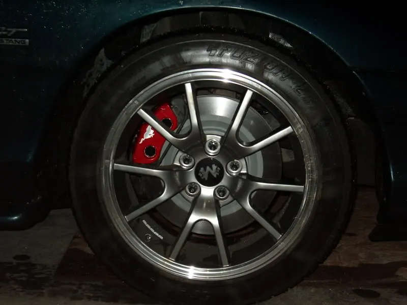

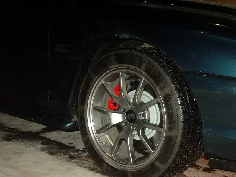

How does it look with the new rims? must be badass. pictures?

Here's a couple pics, but the car was really dirty
I'm waxing the car this weekend, there will be plenty of pic-whoaring to come :rolleyes:
