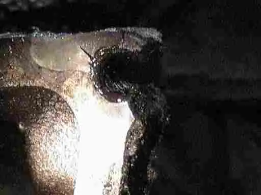

oh yeah.... I will call chp and dss friday and see what they have to say.. i want to order it asap. i was hoping to get my engine together by the end of the year, but my stock block, had on of the trany mount ears broken off, really great.. so I'm at sqaure one with no money..
heres the picture..
