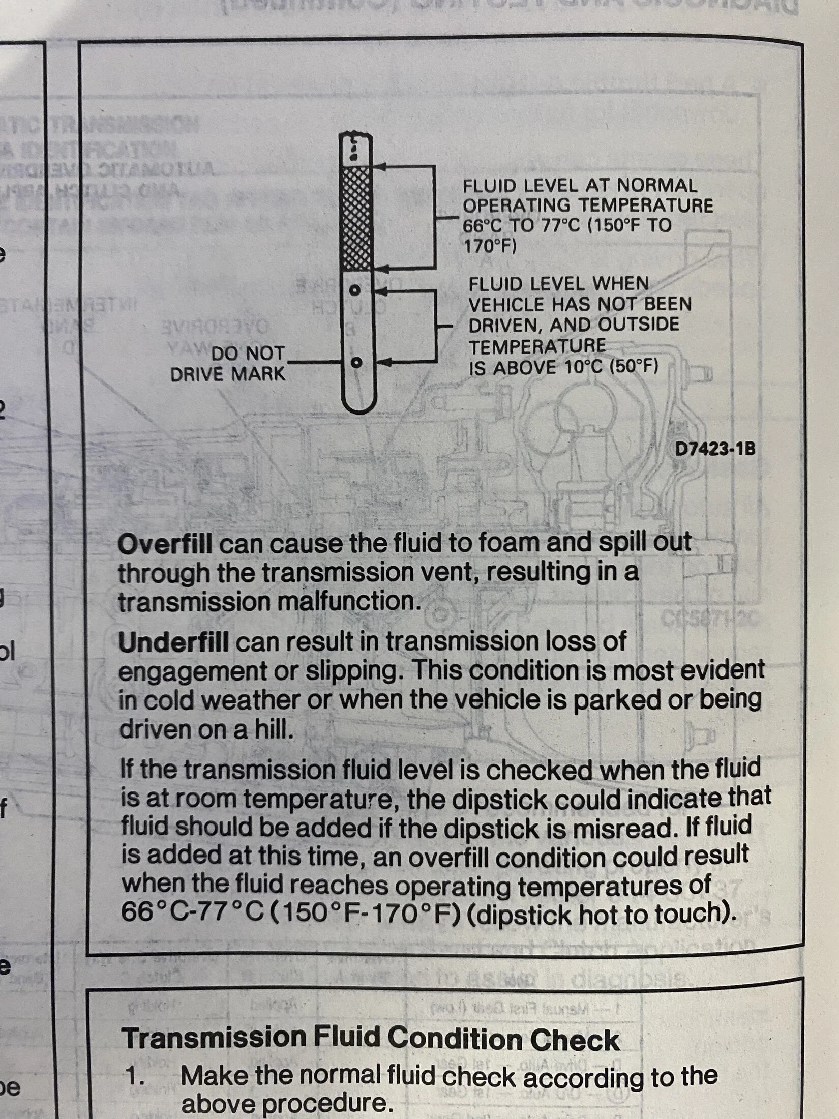

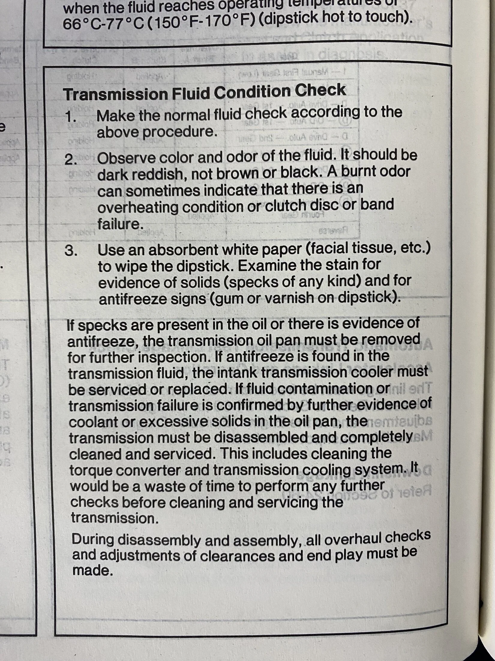

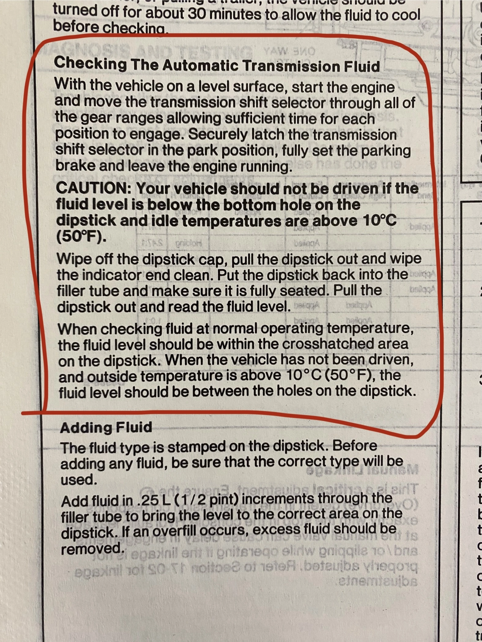

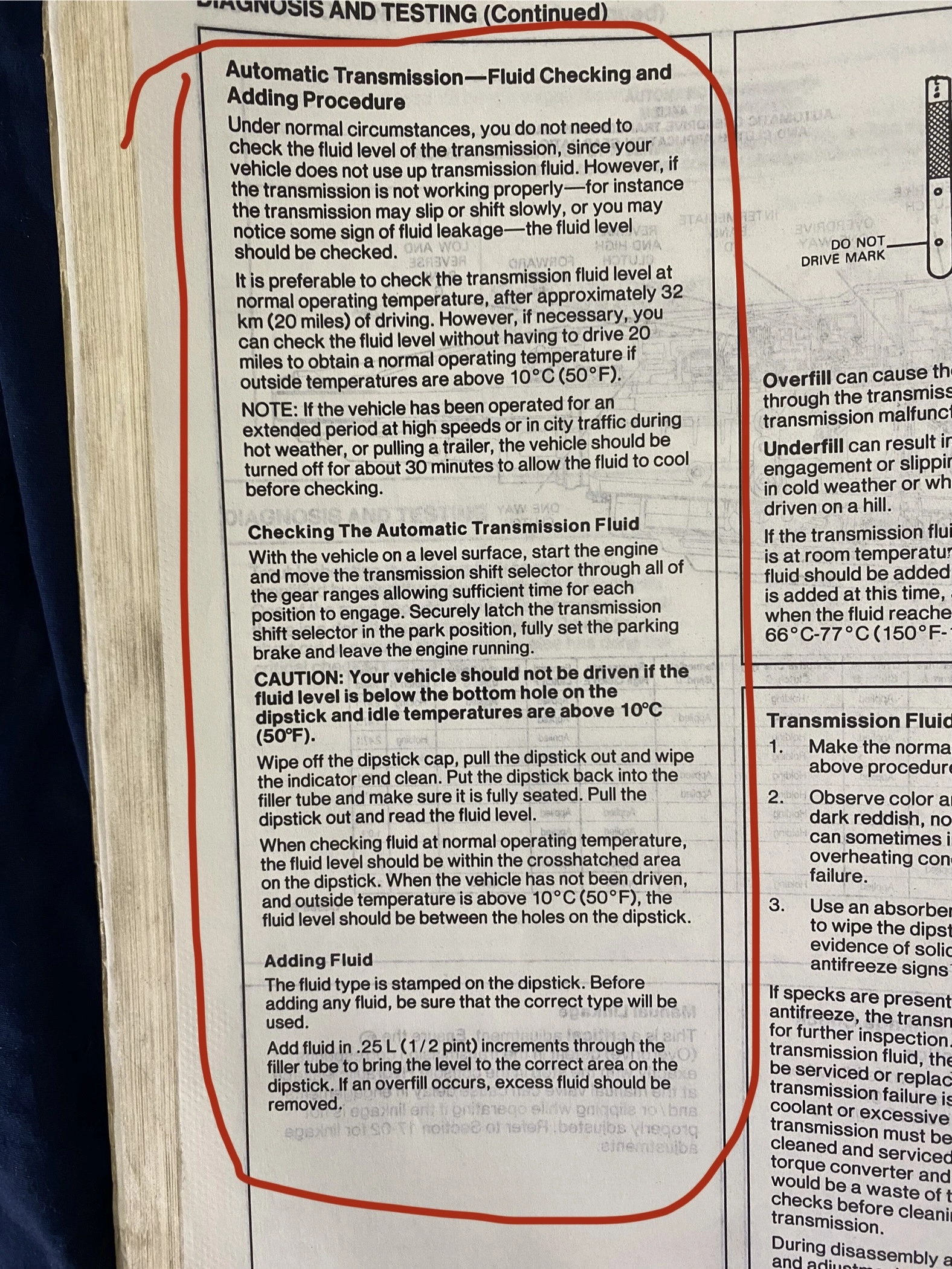

This is from the Ford 1991 service manual and AOD specific. See attached photos. Hope this helps:
Another reference for the fluid level check procedure is usually engraved directly onto the dipstick itself. It’s basic obviously since there is limited space for engraving / stamping.
