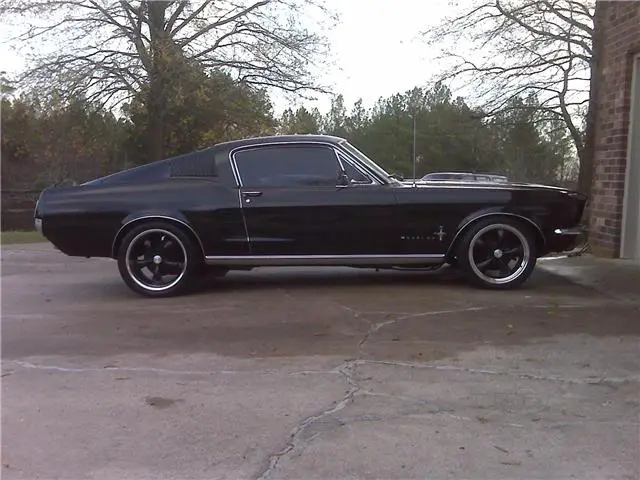

I'm putting a set of 17x8 Bullitts on the front of my 67 Fastback, and I am going to run a 1" wheel adapter to make them fit. Where would I find a good wheel adapter that I can trust. Found some on ebay for around $60.00. Also found a set of H&R's for around $150.
Any of you guys know of a site where I can find some reliable ones?

Thanks! I actually went with H&R's 25mm adapter. They were more expensive but H&R makes quality products and this definetly isn't something I want breaking on me.

Finally got the wheels on. Went with H&R's 25mm adapter on the front. Seemed to be a very good quality spacer.
