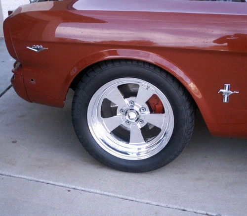

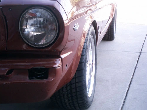

I have a new submission for the charts
16x8 (4.5" backspacing) with 245 45 ZR16s that fit completely inside the wheel wells (not even close to sticking out) Even got photos to prove it
Of course the explanation is lengthy, but the setup works...

A couple of photos of the new American Racing rims and wheel fitment for Stangnet viewing pleasures.
