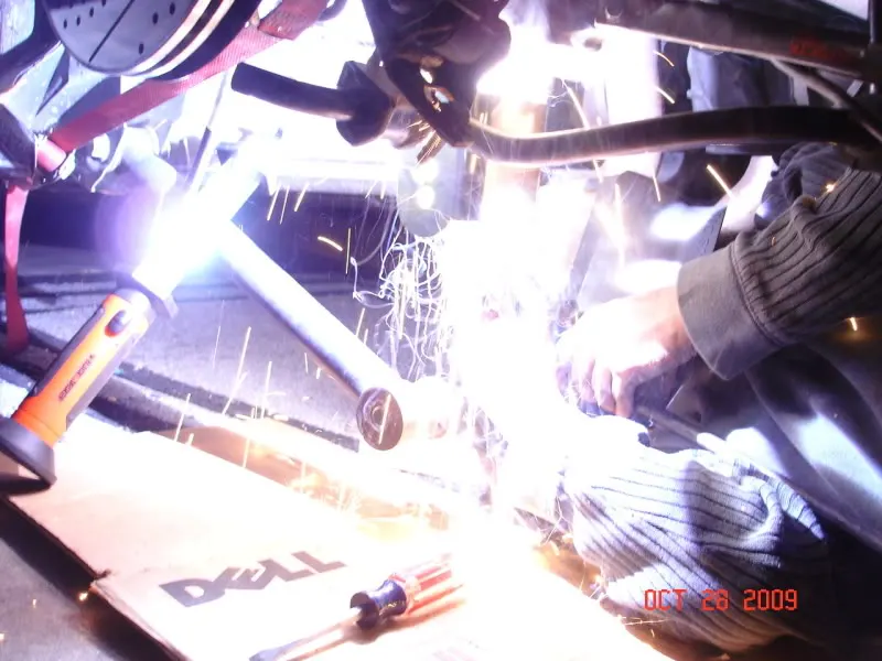

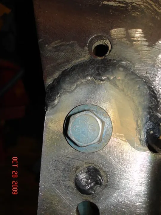

You need brackets if you lower the car to any degree, regardless of the control arms. Look under the rear of the car and your control arms will be pointing upwards instead of slightly down. BMR do them although if you're not going back to stock ever, it's worth welding them on due to the high stresses placed on them. Plenty of places do them advertised thus:
# Allows rear control arms to be adjusted lower for increased traction at the drag strip.
# Improves street and race car performance coming out of turns.
# Brackets weld on with ease. ( We do not recommend bolting this type of bracket on
due to the high loads placed on them).
# A must for lowered cars. (Brings back your instantaneous center that was lost
when you lowered it).
Steeda relo brackets welded in, UPR lowers = NO MORE WHEEL HOP!
