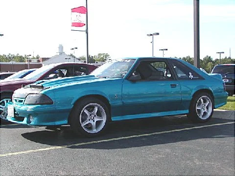

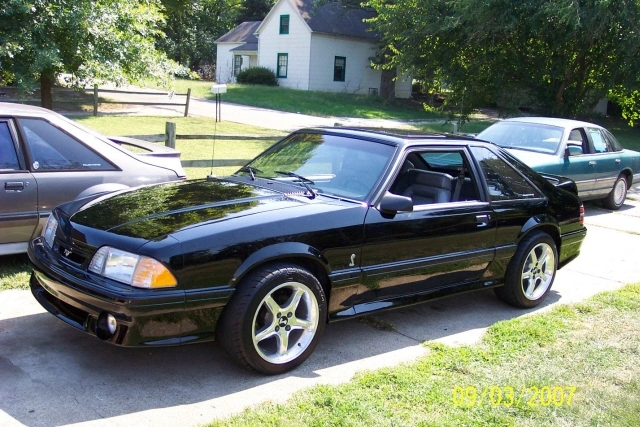

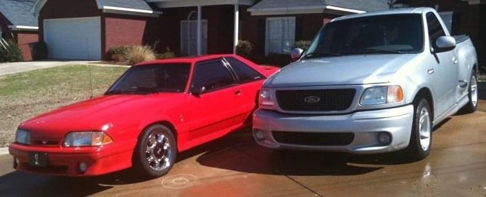

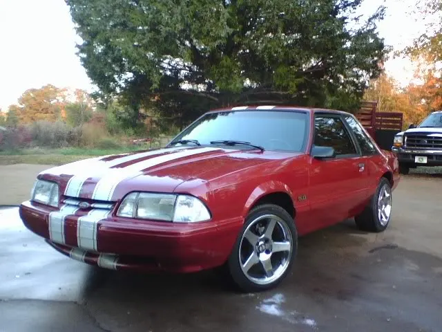

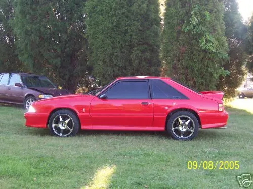

I found a few pictures of 93 cobras with some different wheels..
hopefully that means this is a possibility.

I got the 03 cobra style wheels on mine and love em. Those y2k wheels on that red GT r sharp tho

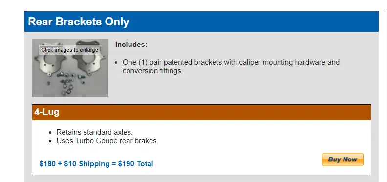

Just swap to standard 5.0 front rotors, and purchase these brackets along with a set of non-cobra 4-lug axles. You might need to modify the anti-moan brackets a bit however. But that will pull the front and rear in that 0.75" you need and then you can run the replica wheels. Squirrel away your stock parts as it's not a terrible job swapping the brackets and such back.

Yeah I know I cando all that. And might have to. But then it’s not a cobra anymore basically truened a true cobra into a clone. Lol I just wish someone would make the correct rim for us. I know quite a few guys that would buy them right up. So we don’t have to change anything. I still have the stock radio,floor mats, dust boot on distributor.Original paint.
