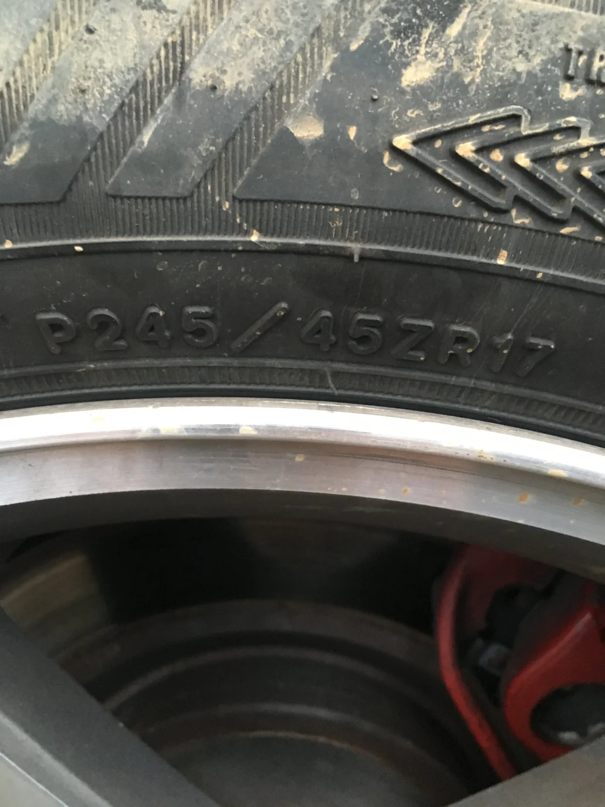

Thanks! I read up about these screws and other bead locking items. So I understand now why they’re on there due to the slicks that we’re being run in the car at one point

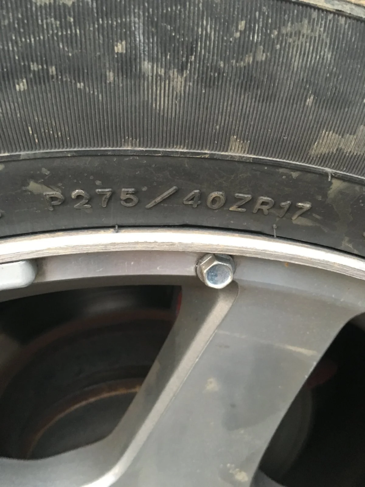

Well I thought that had them in the picture. Anyways. They’re right on the outermost of the wheel right before the lip. I kind of hate them cause these are the original wheels with the 01 cobra and the screw heads make them look tacky
Hi,
Yeah, close to seeing them in the 1st pic, not quite. Close only works when playing Horseshoes or throwing hand grenades, lol. Yes, hex head screws stick out like a sore thumb, unfortunately.

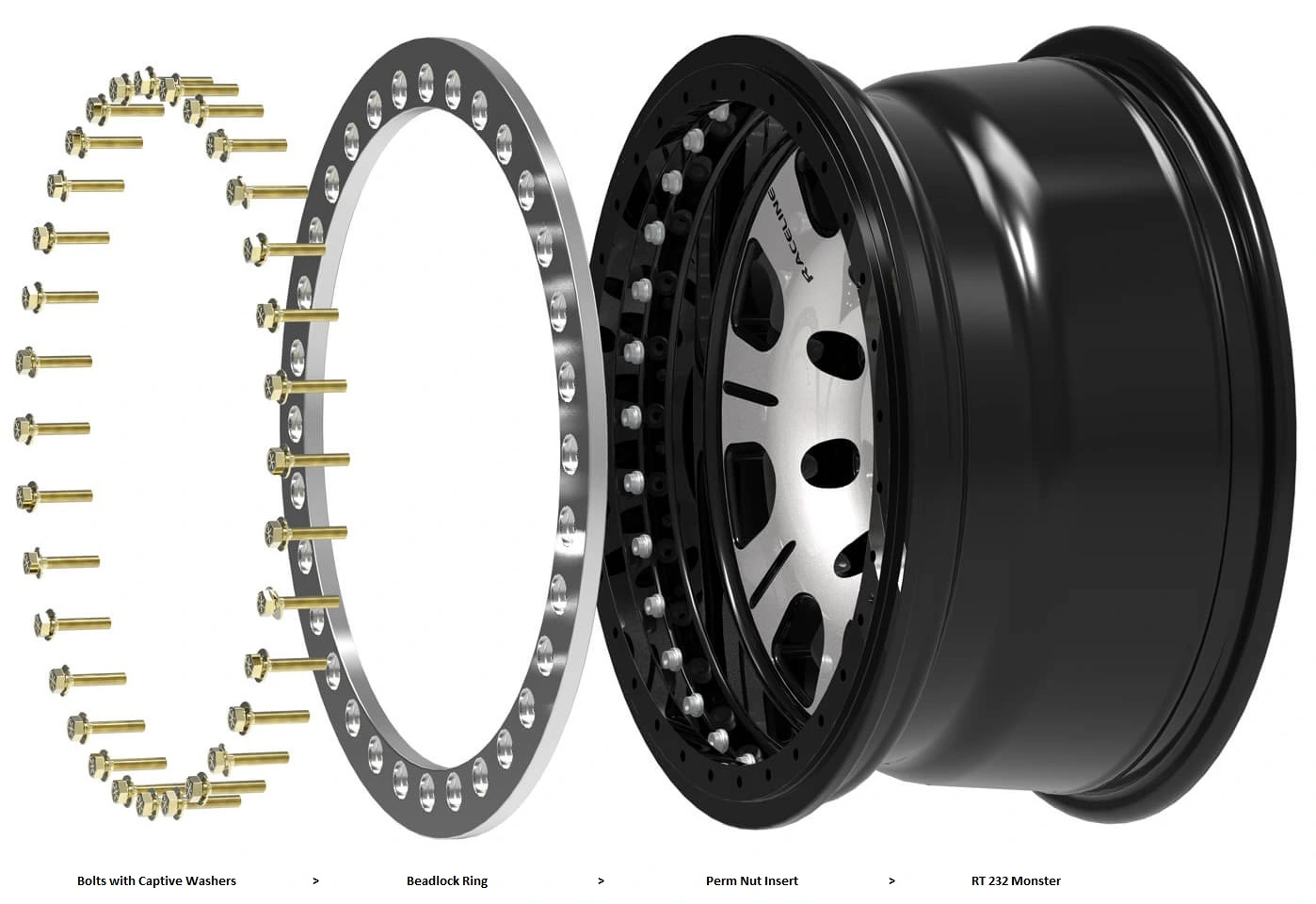

As typical tubeless tires rely on air pressure to thrust the tire firmly against the seal surface (bead) of the rim, sidewall’s absorbs some of the shock. Running bead-locks creates an equal mechanical clamp force across retaining the bead when purposely dropping air pressure(s) very low.
Without bead-locks, the tire would not only go completely flat, it’d likely fall off the rim & destroy both.
WHY BEADLOCKS?
Extreme Rock-climbing, Enduro, high HP Drags with Street or Race slicks are a few examples of conditions of which bead locks are really useful, otherwise..mainly aesthetics.
Pictured below is what headlocks generally consist of, some run tubes inside the tires so they can drill & tap the rims & punch a hole in the tire, run the screws in & have no concerns about leaks..
