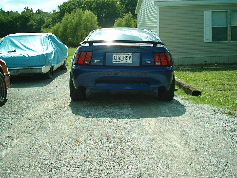

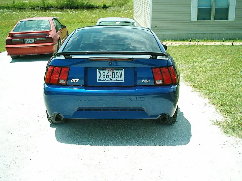

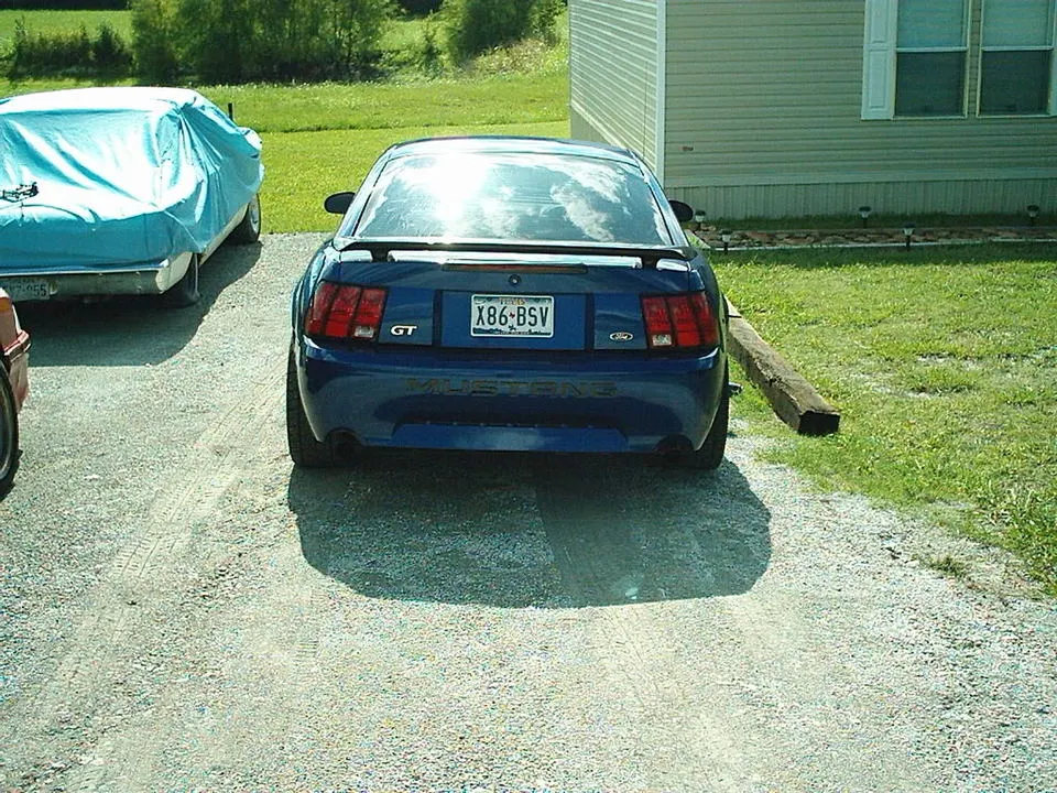

These are 1.5 inch spacers on my car. Made a huge difference in looks, not only from behind, but it looks more aggressive from any angle now too.
Before:
After:
