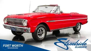

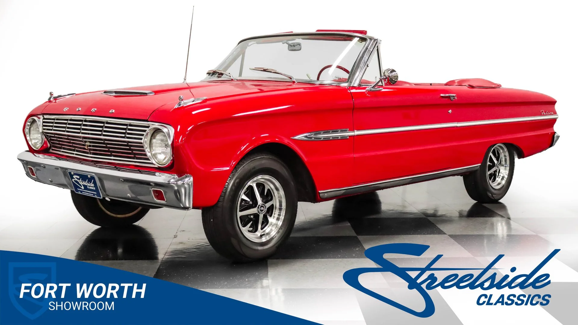

If you do decide to try 6 inch wide wheels - and they fit - you could switch it up and go with the Magnum 400 wheels. They're offered in the correct bolt spacing and would dress the car up some. Just a thought. :)
Edit: I figured it would've had to have been done, so a quick search awarded me with a few different examples! Here are a couple to give you an idea....
