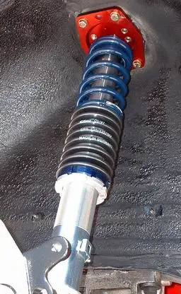

My struts look like those on the picture but w/o caster camber (not my car on the picture)
Those look like coil-overs, not struts. A stiff spring can overheat your shocks, making the seals wear out faster. They are probably rebuildable if they are a good brand, so you should probably get that done, to match your springs. Without shock absorbers, your tire would bounce down the road at speed, like a basketball. That gives you the shaking feeling. The fact that you feel the shaking at high speed even when not braking is what tells me it is the shocks, not the brakes.

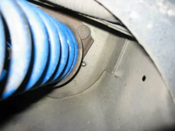

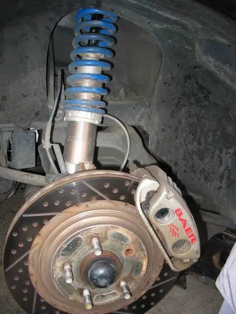

Here is two picture I took today on the coil-over when I was thinking to change the wheel stud that has broken, but that one I had (for the rear) didn’t fit in the front… :bang:
MatteMan said:
Okay, so you mean if I don´t fix caster camber plates, it´s no idea to fix the alignment?
With a lowered Mustang you will need aftermarket CC plates to be able to get the alignment into spec, the stock plates do not allow enough adjustment. Of this I am certain.
There are 3 bolt and 4 bolt. I have been told that coilover suspension on our cars should use 4 bolt. I am somewhat talking out of my ass here because I cannot tell you why, other than relying on the expertise of several friends. Maybe someone who knows a bit more can elaborate.
Here is a bit of info you can read through..
http://www.maximummotorsports.com/ccFAQ.asp
Based on the response to these two questions it appears that the reason for going to 4 bolt with the coilovers is that the added pressure of the spring and strut, rather than just the strut in a common Mustang application, will cause additional pressure on the CC plate. On the three bolt design, the bolts are not in a triangular position, rather more like an L, causing more stress on two of the bolts with the potential of bending the CC plate. The fourth bolt gives the added rigidity needed to support the weight of the car on the strit tower / CC plate.
