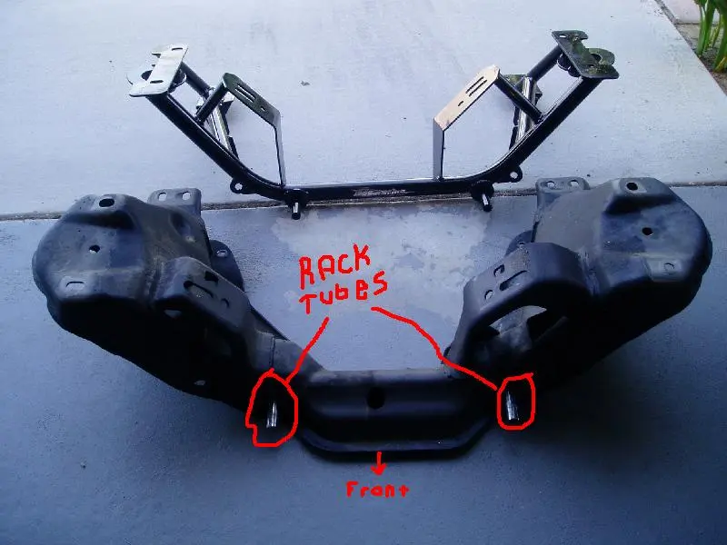

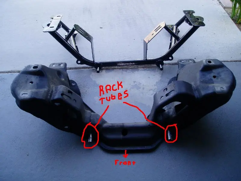

They stick out of the front of the K member about 2 inches. The rack bushings slide over them and this is what holds the rack to the frame. They are pressed into the front of the K and bottom against the back side where they bind against the back of the K.
Forgive the crudeness of the pic. I'm doing this with a laptop and mousepad.:D
Thanks for taking the time to show a visual.. the noise is really annoying.. I've just been turning up the volume on my stereo so it doesn't make me angry:)

If you look at the side of the K where the forward mount for the 'A' arm is, you can see the rest of the tube. It doesn't go through the back wall of the K, but gets pulled back into it by the bolt that runs through it. That is what I am thinking is rubbing causing the noise. It always goes away when I tighten/retorque the rack bolts but always comes back. I've just tried spraying some lube up into this area and I'll report back tomorrow on how it works.
