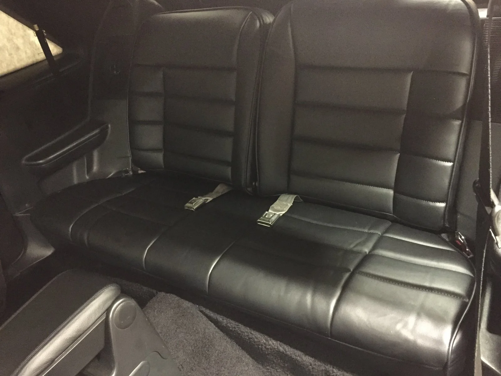

Here's mine I did this past fall. I bought the seat parts on eBay for around $150ish. Originally an 87-89 red tweed seat bottom and some 90-93 4cyl backs with the corbeau vinyl rear seat kit installed
Still need seatbelts
