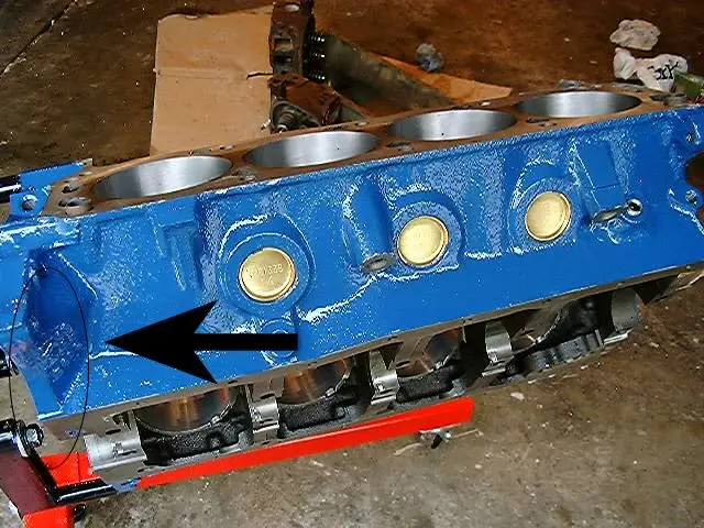

on the pass side, by where the starter would go is the only way to tell what year the block was made or at least what casting ford used.

strokedandblown
Banned
May 3, 2005
555
USA
Jul 18, 2005
  • Jul 18, 2005
I always mix that up good pic!
