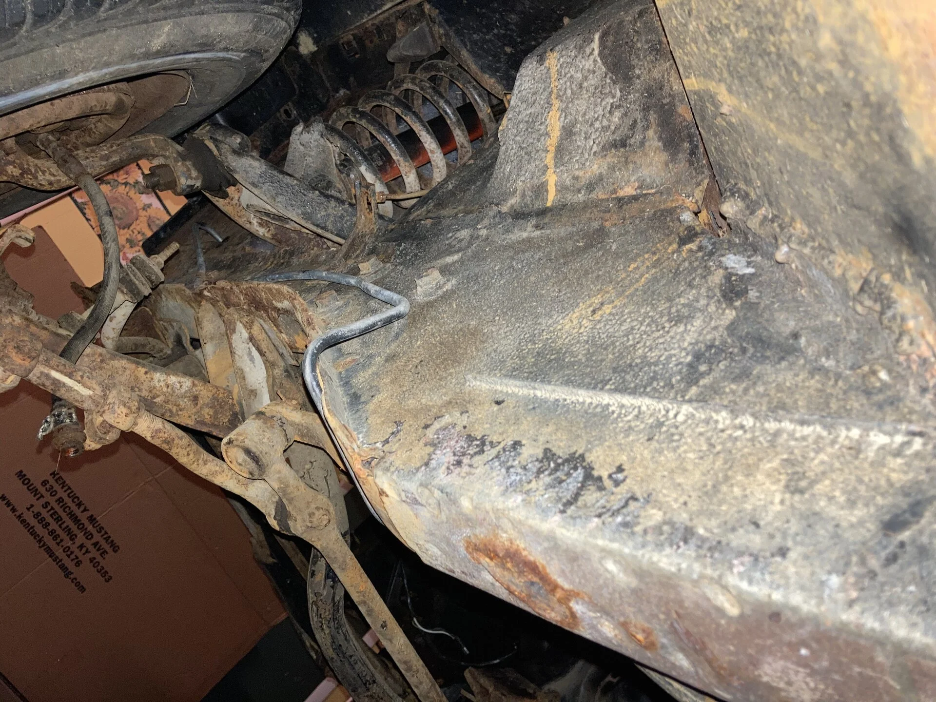

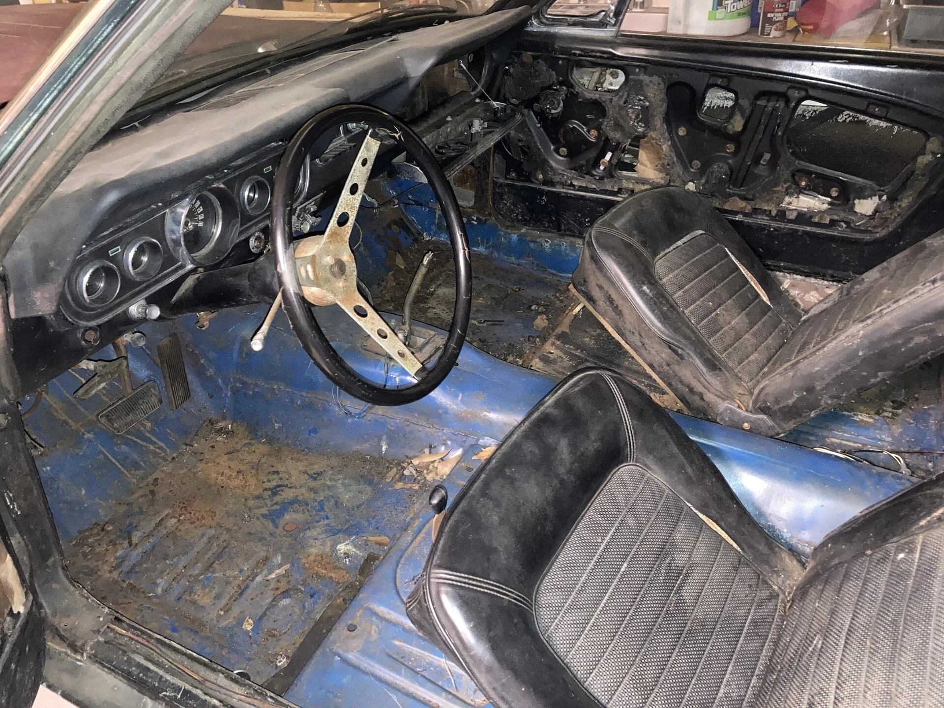

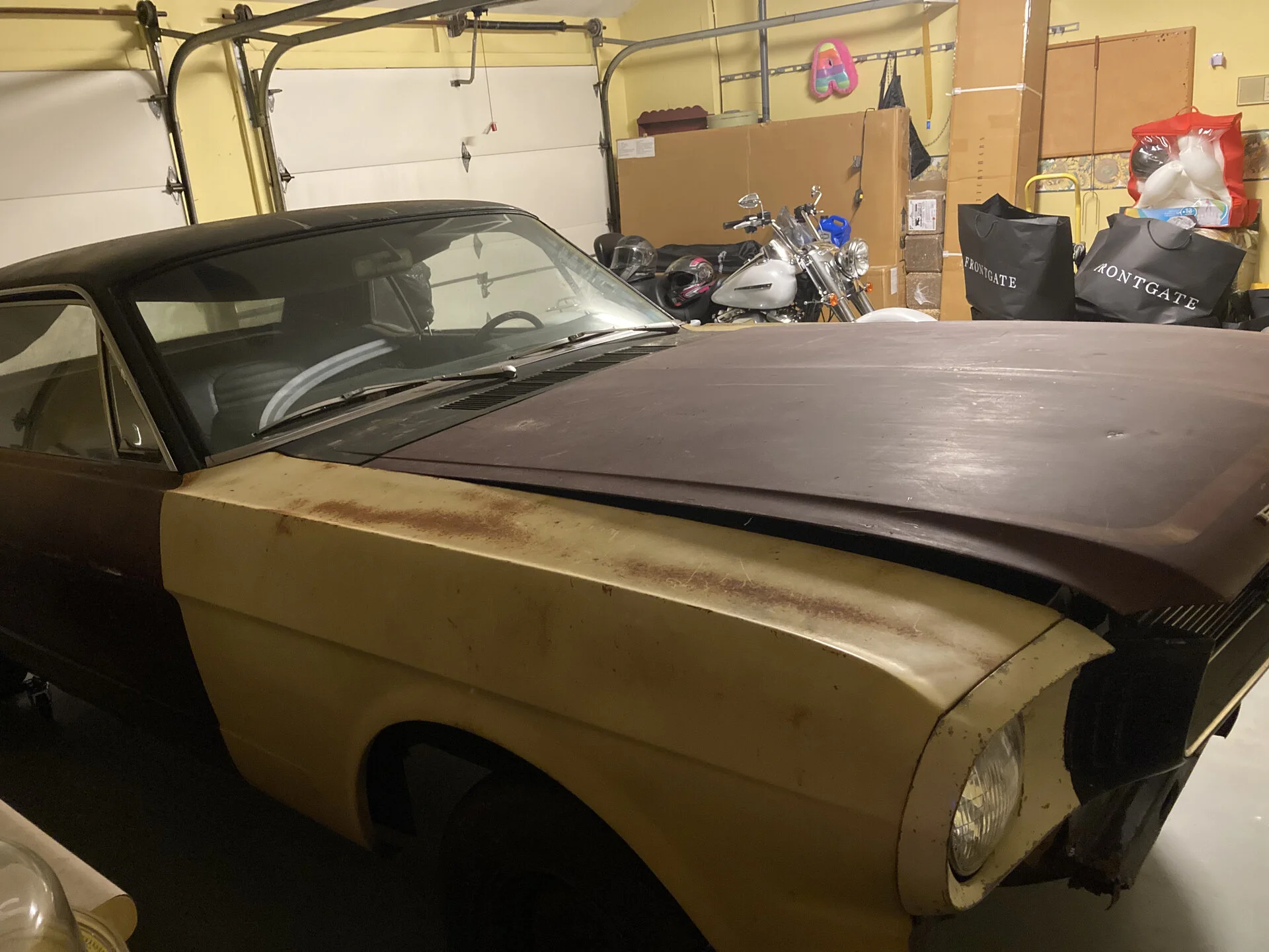

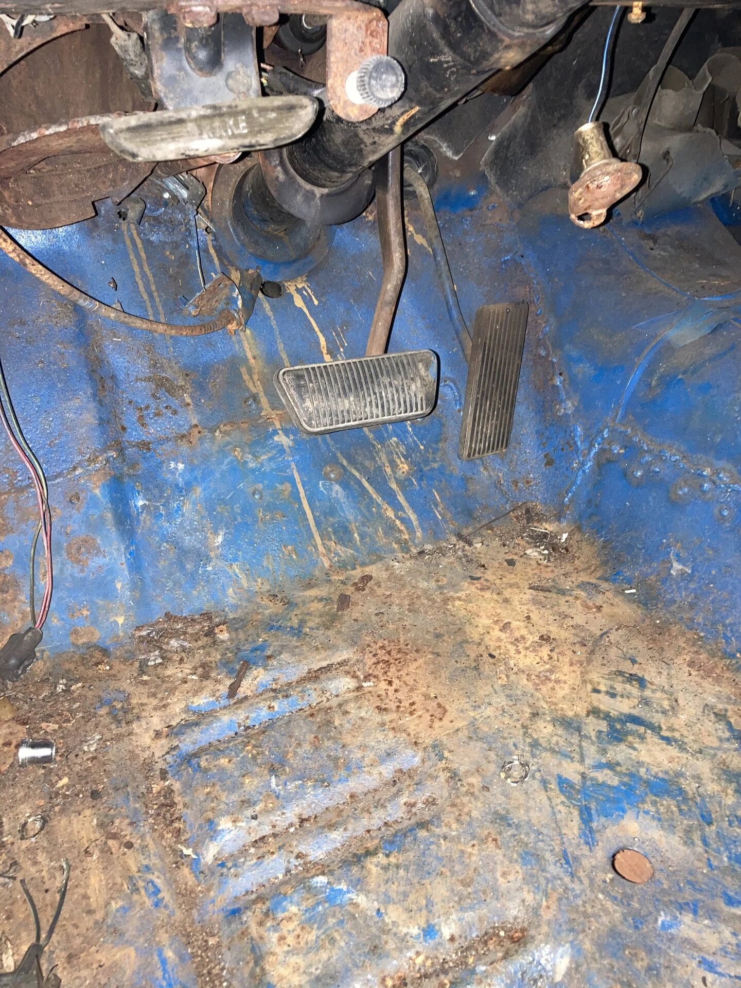

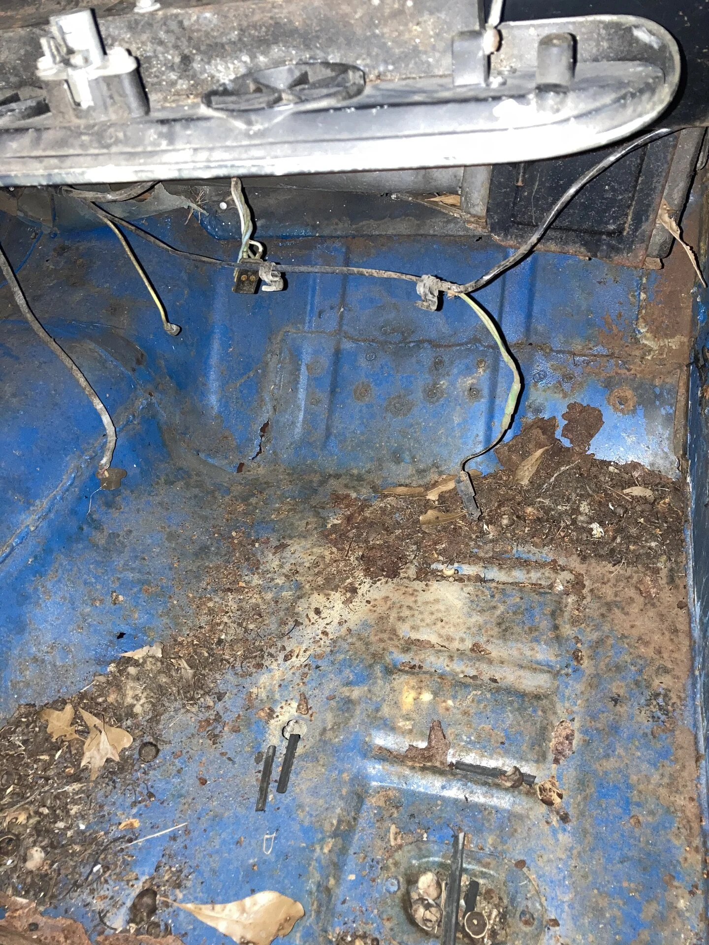

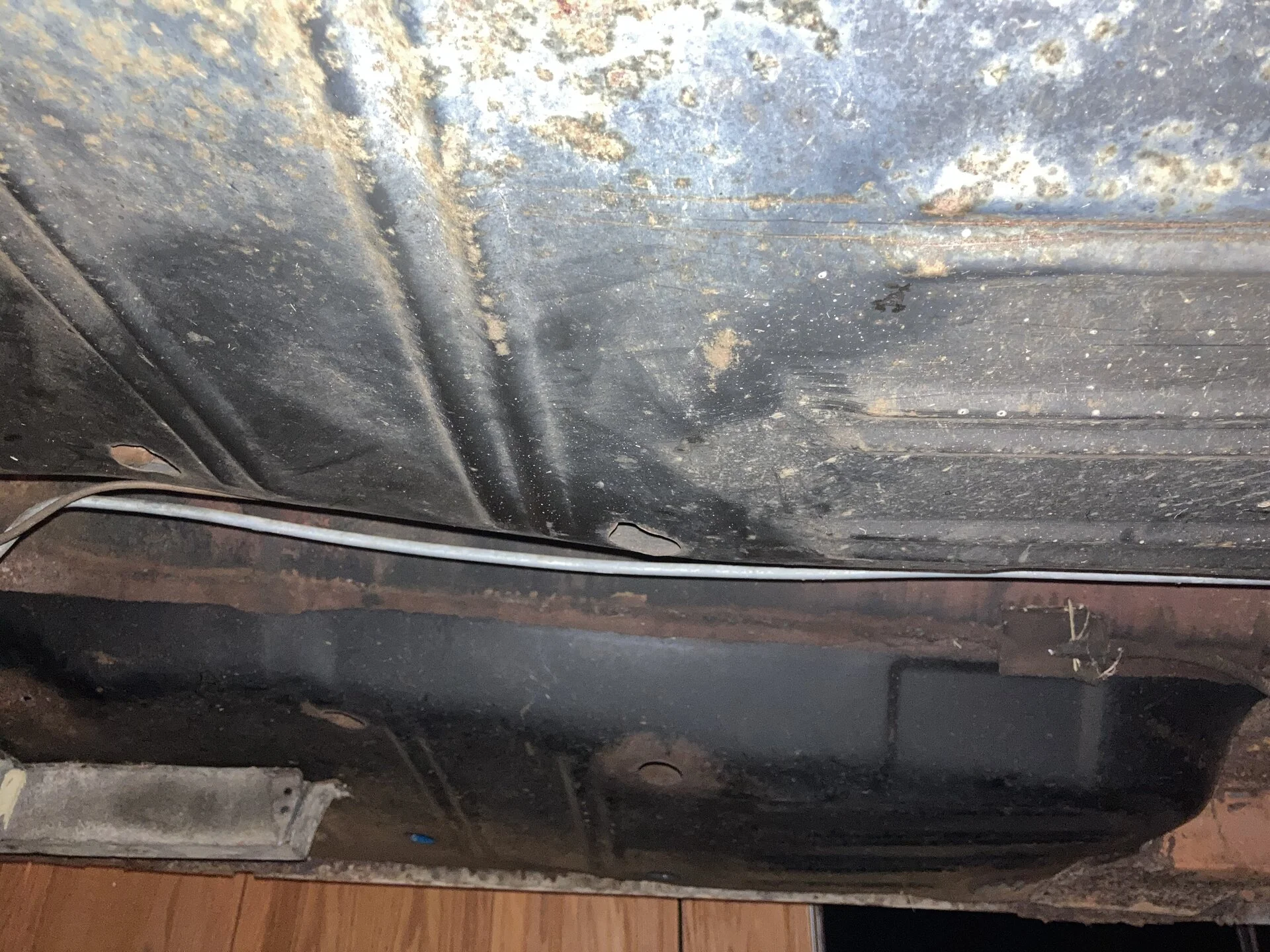

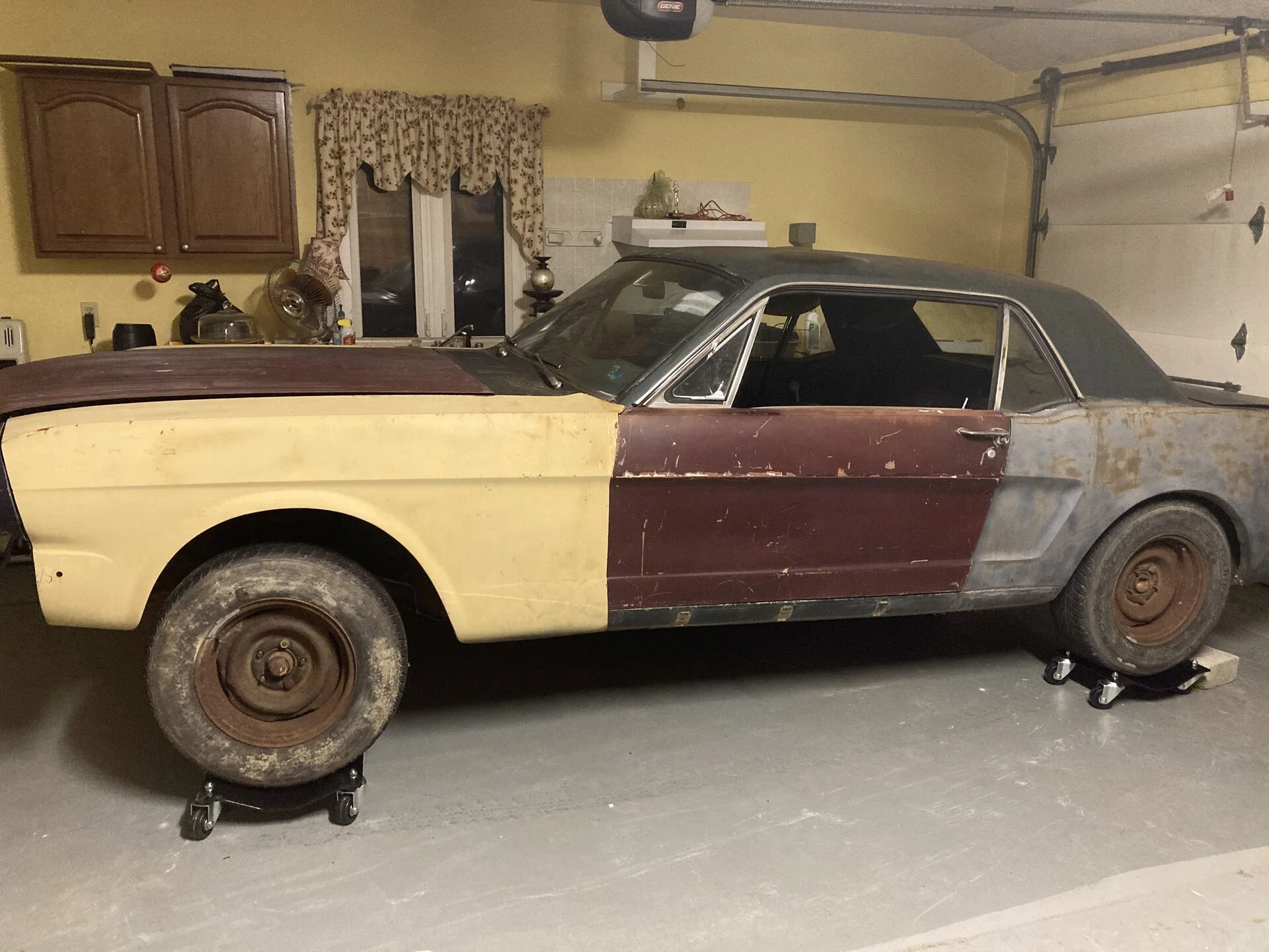

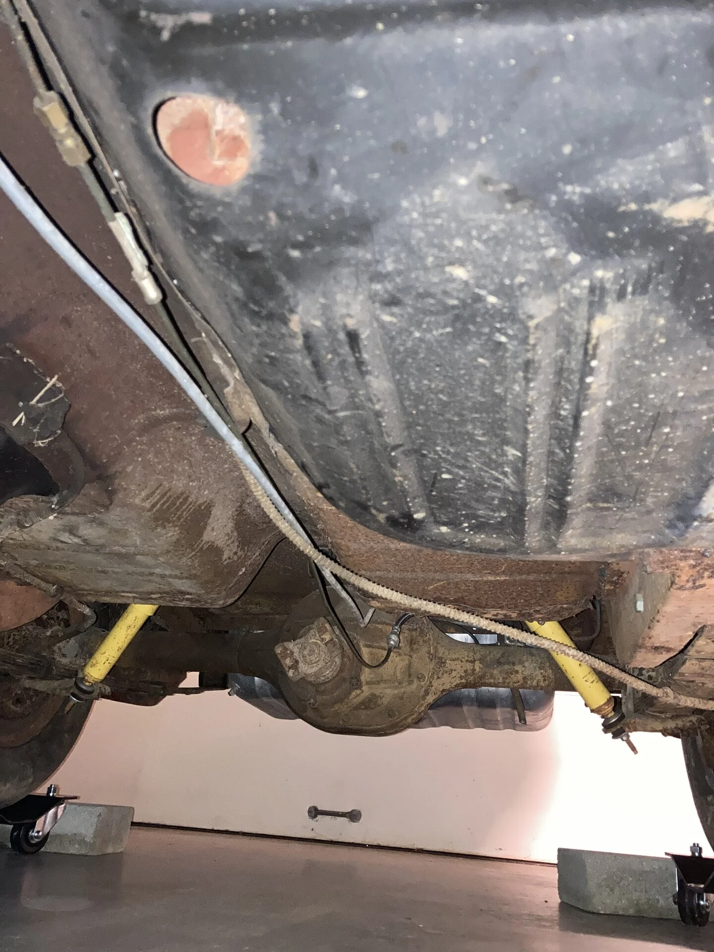

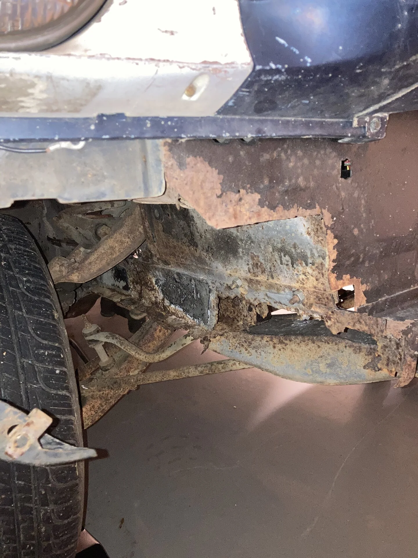

Only thing I see that I would fix is the front rails. Looks like it has already had a floor and it's not too bad shape. Cowl could be bad but pics don't show (probably is). If you want to do it "right", strip it to bare body and have the whole thing media blasted, fix what is found, build it back. If you don't want to go that far, fix what you can see and build it. But I don't see a ton of sheetmetal that needs replaced in the photos. My .02
Reactions: 7991LXnSHO
The cowl and front frame rails will need to be replaced. I have purchased a new radiator support. The loose rust in floor is from the lower cowl area . Thanks for the feedback. I appreciate it.

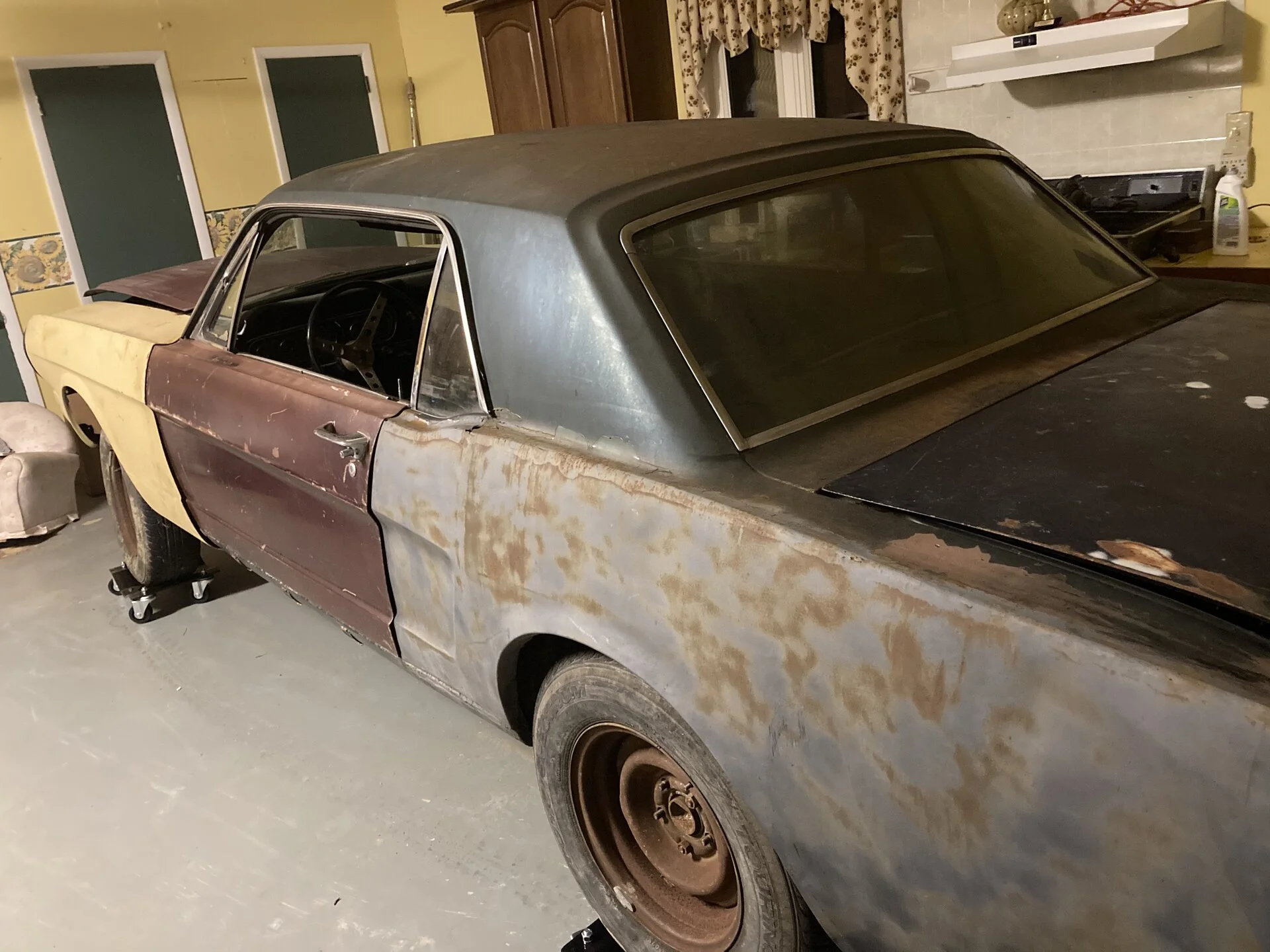

I’m concerned about aligning quarter panels myself probably more than anything else at this point. The previous owner found a very good set of matching factory front fenders and matching set of factory doors and put them on the car but didn’t take the time do any alignment. So now the fenders and doors are not aligned to the quarters. The quarters have obviously been replaced in the past as you can see where the quarters were seamed along the upper ridge line of the quarter. I’m hoping that who ever replaced the original quarters actually took the time to properly align them. My thought is to align the doors to the current quarters before I begin to replace anything else. I will then use the doors to align the front fenders and the new replacement quarters, hopefully creating clean alignment from front to rear. Any thoughts on that idea? Thanks.
I just took a ton of pictures of the door gaps and body line alignment before removing my quarters and used that as the standard for alignment on re-install for that particular line, essentially the same as what you are saying....but be aware that trunk lid alignment is an issue, or was for me since the last couple inches of the sheet metal crease on the new quarters dived inboard slightly compared to the rest where the factory ones didn't. I didn't realize this until afterward so now I am going to have to work the trunk lid to compensate, which I guess is alright since I am planning on a fiberglass lid anyway, it will be easy enough to add a bit of fiberglass to fill in the resulting gap.
