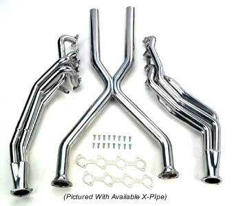

OK, the reason that you don't have to remove the Hookers headers when pulling the trannie is because they are spread out more than any other design. This is also why no other H or X pipe (other than Hooker's own X) will work without modification. Notice in the pic below how wide the top of the X is. The trannie and even the bellhousing can come out without removal of the headers.
My question is why cats? These headers are likely not going to pass emission testing, but if you want cats to cut down on the tone a bit, either you'll need a custom mid pipe made or have cats added to the Hooker X pipe.
