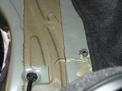

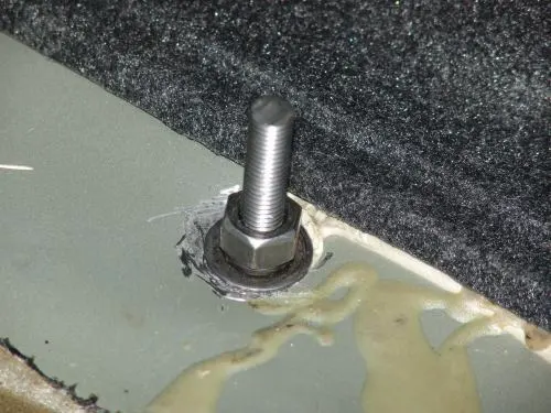

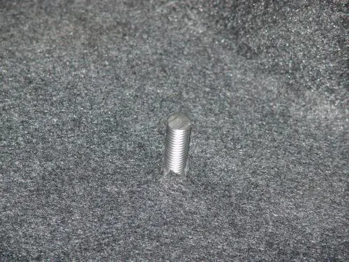

Thanks for all of the help guys. I took several of your ideas, plus the idea of GI Joe from here at Stangnet and created a grounding post in the trunk that is attached directly to the frame via a drain hole in teh trunk.
Seems like a stout ground that will allow me to connect both my battery and aftermarket sub amp grounds. I like the idea of keeping the wires inside the cabin.
Here are a few shots of the final product.
~Darren
