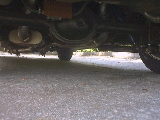

You probably have already decided where to place it but mine is just below the pickup attached to a piece of sheetmetal which is attached to the body. The picture isn't the best but it gives an idea.
