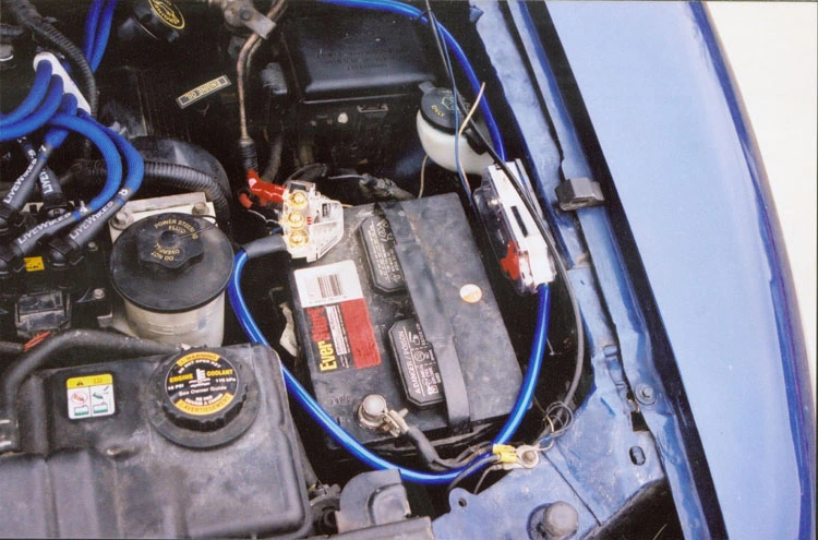

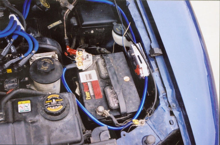

right next to the battery...engine is dirty in this pic, I know..
