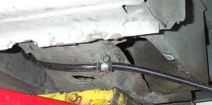

I didn't buy a kit I pieced it together. A lot of things on a fox looked "rigged" so the springs would be no different. I appreciate 9 deuce's easy fix option as that was what I was looking for. I would have gone with it if I didn't have to run back and forth to lowe's to find the right size spring. I took another route.

What year is your mustang? 93? if so then I think the routing is different as on mine the cable will run against the tire if I didn't pull it back. On the 93, 94+ there is an additional bracket that pulls it away from the tire. I bought the 2809 (?) cables that most people get when they convert to 5 lug. I can take pics if you want to show you that it rubs. So I got a rubber isolated 1/4" clamp to pull it further underneath the car. In the pic I posted you can see that the clamp is set under the torque box. The stock location puts it along the inner side of the rocker panel right in front of the tire which when hooked to the rear of the disc brake makes it rub. NO worries here. I just didn't want anyone getting all bent up over something silly. LOL. I got ya though. Thanks for your help as well.
