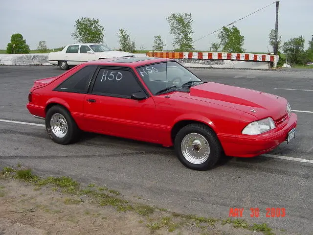

The reason i mentioned 12 degrees of timing is to reduce the chance of hurting your engine because its running lean. With 19# inj, it is running lean. When I had my car dynoed I had 24# inj's on it with a 255 lph pump and it went lean at about 5700 rpm. I put 30#'s on and its fixed. Runs a little rich sometimes, but it made 347hp and 384lb/ft at the wheels. If you dont have a stall converter in your car with that aod save your money and get one. You will be very happy. C&L meters also work very well, The 76mm with tube is a nice piece. Good luck and dont blow it up before you get more fuel.
ooooo i see. Whats your setup? Looks like i need some 24's. From what i'm getting from you guys, i'm going to run lean no matter what i do with 19lbs injectors. I'll try all the other suggestions regardless. Thnk you for all the replies and i'll let you know if something helps alieviate the problem
tom
By the looks of what you have yes the 19lb'rs need to go. I sent a pic of my rig in race trim. I wrote most of my setup back a little ways in this thread, I dont know how write it out and keep it with my posts and replies.
