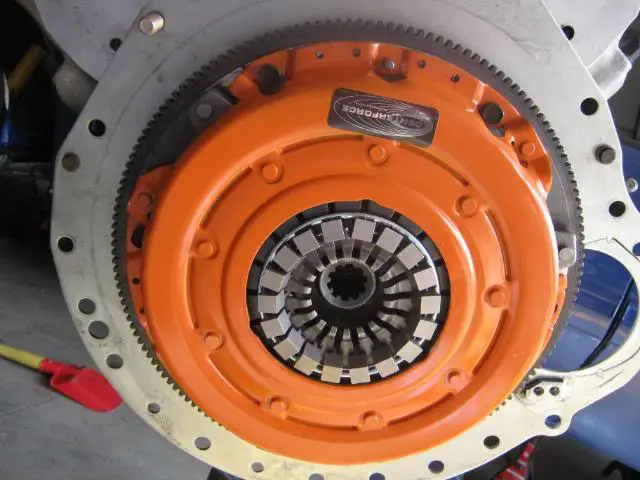

I have been very happy with my Centerforce Dual Friction, but only have the stock one to compair it to.

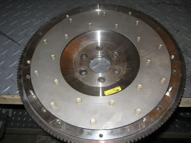

I also put in a Fidenza flywheel, nice to have the replacable friction surfaces.

+1.....centerforce dual friction. i also ran the king cobra...it too was a nice clutch but it couldn't compare to the cfdf.

Avoid an aluminum flywheel with a street driven car. The engine must be revved higher to make smooth jerk- free starts in Creep & Crawl traffic. Aluminum flywheels are great for road race and circle track racing where the engine must spin up and down very quickly. The extra inertia of a cast iron flywheel smooths out the takeoff of a heavy street drive car

the holding power of the cfdf is better suited for my set up. i was using the kc prior to the blower. the pedal feel is about the same to me. i'm surprised the cfdf is about equal to or a tad lighter than the kc. i think you'll be pleased with either.
