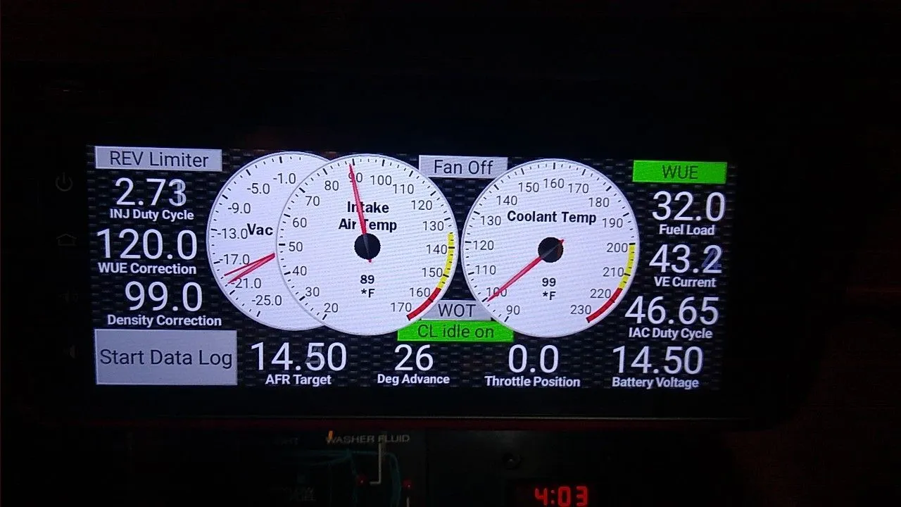

I came to the same conclusion as Bird_dog. Was already having small driveability issues with the DA1 and mild mods, the PimpXS was endless freedom for a small amount of money over a MAF swap. The performance difference was astonishing not to mention the ability to tune anything I didn't like. Running Shadow Dash on a Single din touch screen is just icing on the cake.

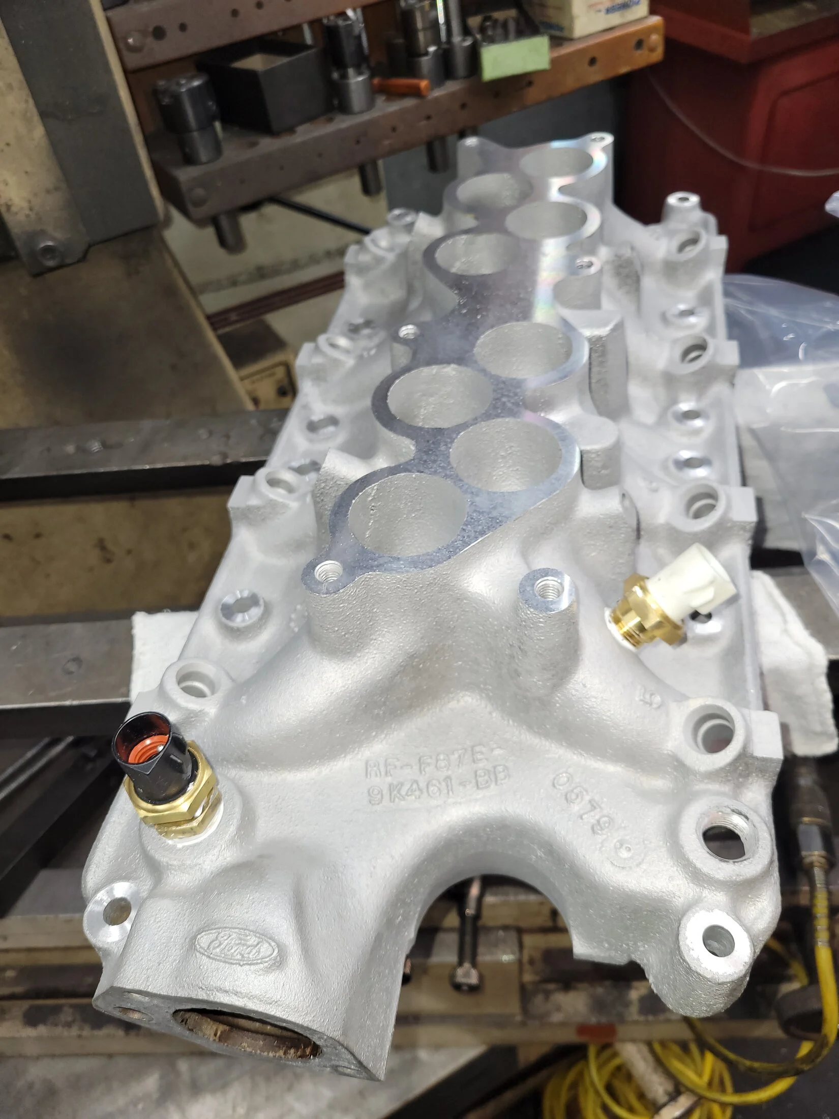

Both the intakes are done. New harness and injectors will be here this weekend.

Bet ya it wouldn't take long to clean those intakes up, get rid of the casting slag, smooth them out.
Probably flow a couple of cfm more.

Not really a concern for me. I just need to get this on the road since it's my daily. I'll do a full porting job when I build a 331 for it.

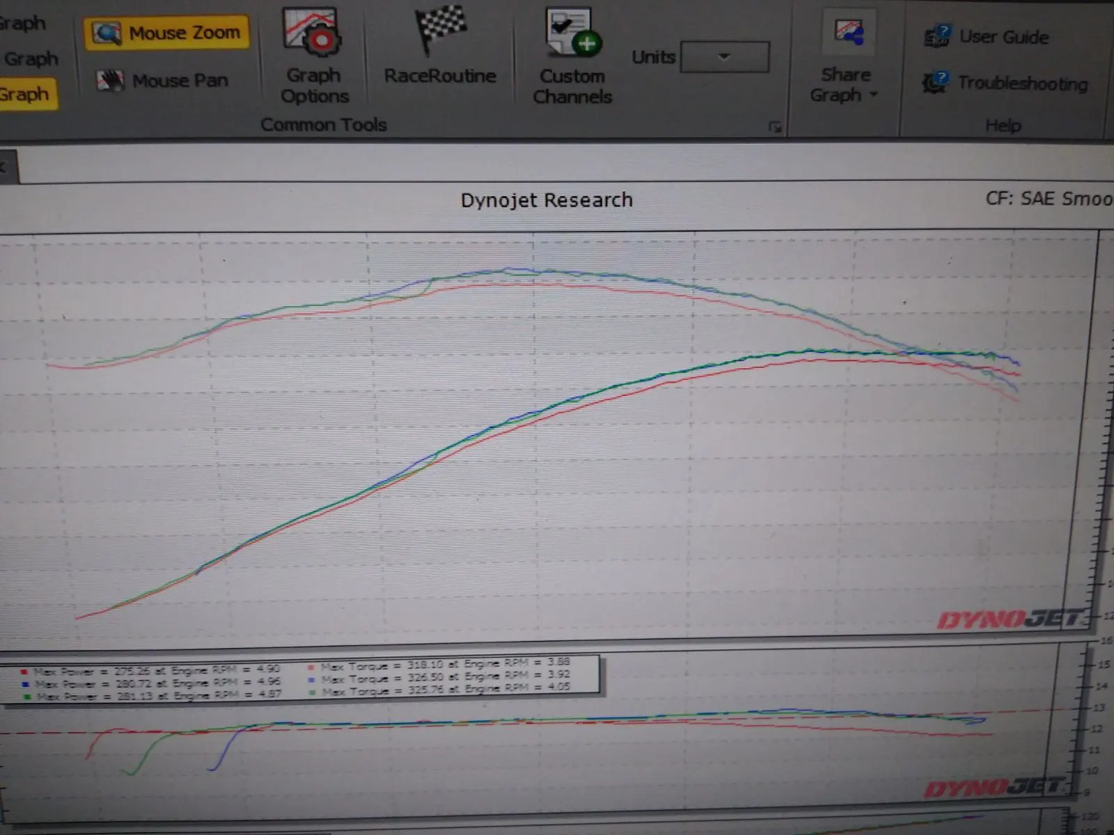

Red line was best pull of 2022, same dyno and operator each time. Pulls made in 4th gear, 3.27's. SAE

Nice looking graft, good daily driver, proves there ain't nothing left after 5k but still fun to drive.

290 at the wheel in a 3400 lb car is nothing to sneeze at. I forget what a 2017 GT weighs but they put down 360-370 to the wheels in stock form.

Thank you, spent a lot of time tuning it. It'll pull well to 5500-5600 then signs off completely.
The mid range torque along with the aluminum flywheel and aluminum Romac balancer makes it an absolute blast to drive.
Car weight is 3100lbs with a full tank of gas.
