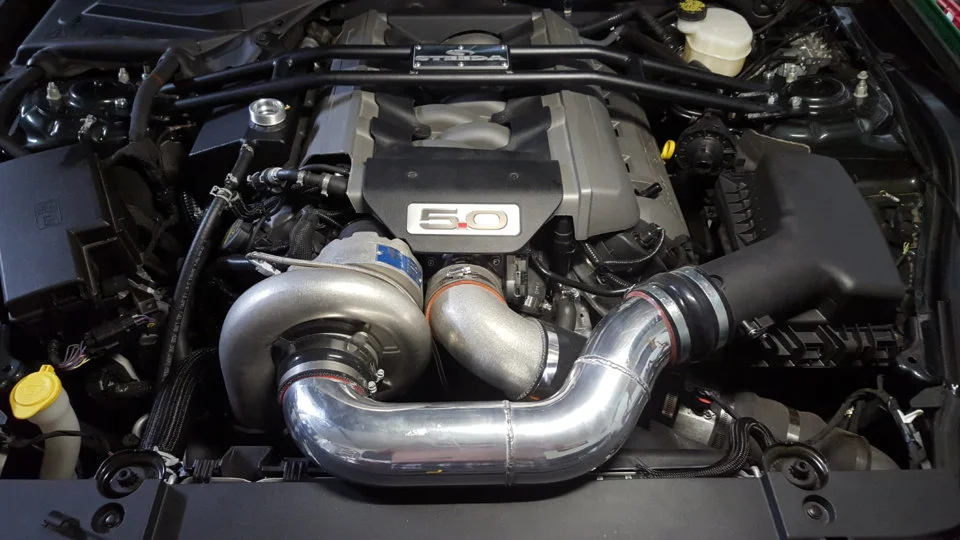

This was after I installed the strut tower brace on my hoopty: (keep in mind that mine is slightly different than the production S550 kits as that this is a JT trim and was done as a prototype preproduction unit.)
