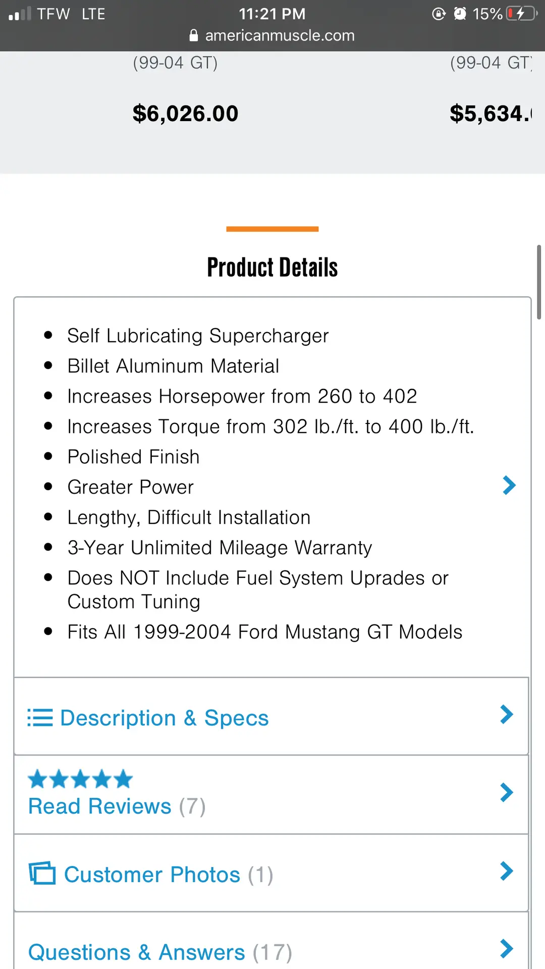

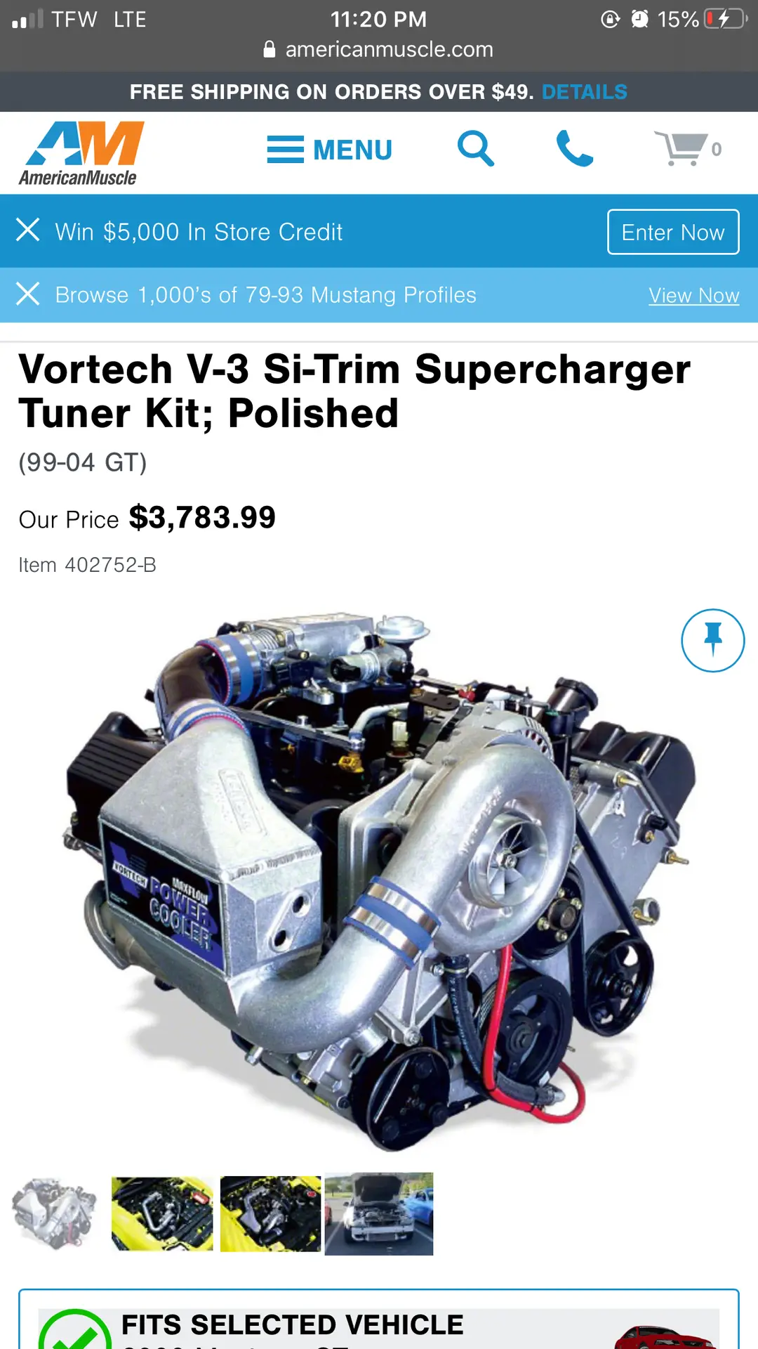

So I’m new to the forced induction but I want to do a supercharger/procharger setup on my 2000 gt. It’s all stock besides cat back exhaust. I found this setup online but I don’t know if it’s all I need or will I have to buy extras for the kit? Also do I need to upgrade injectors or fuel pump? I figure whatever I go with I’ll have to take it to a dyno and let them tune it for best quality.

Anything that says, "Tuner Kit" is going to need more stuff.
Stuff off the top of my head that you will likely need:
Injectors
Fuel pump(s)
Tuner and/or tune. If you're asking these questions you should probably assume a dyno-tune at a speed shop.
New or upgraded brakes
