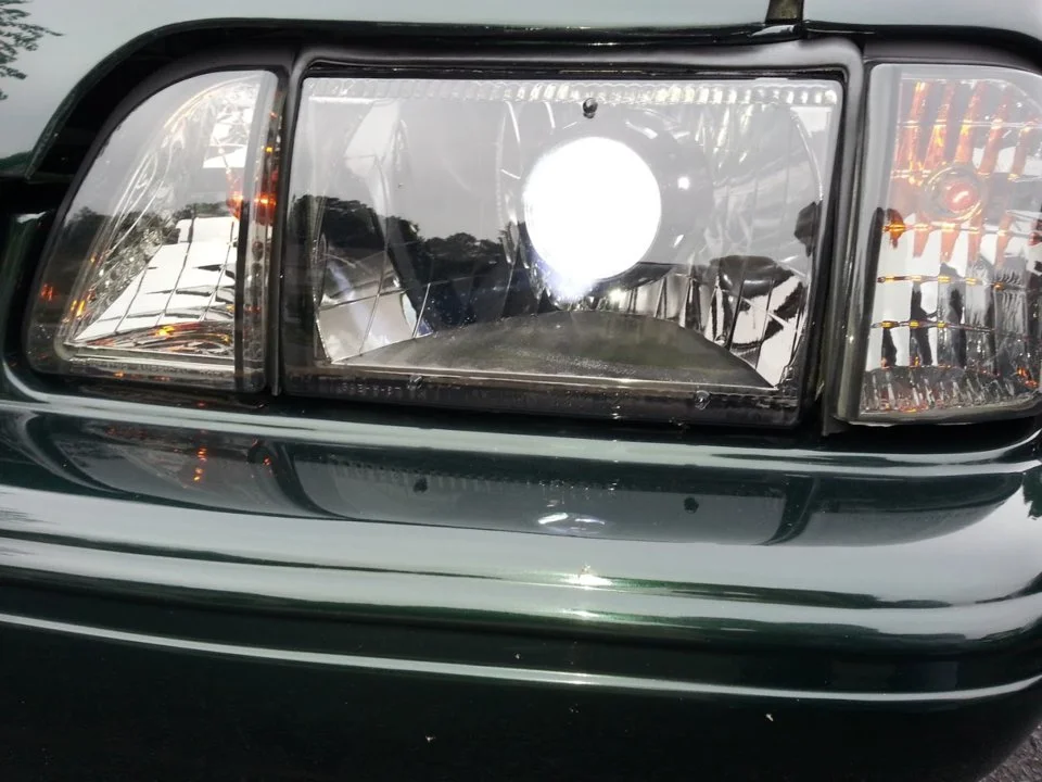

Morimoto HID conversion..... Barely even noticable but the results are well worth the work!

@elarm1
is that the mini stage III kit? I see 3 different Morimoto kits on HIDretrofit website
is that rubber caulking? I definitely don't want something with the rubber seal as they will crack over time. Mine has
He has the after market 3 piece head lights. You need the head light seal/trim kit or you could just get the once piece head lights and then do the HID retrofit kit.

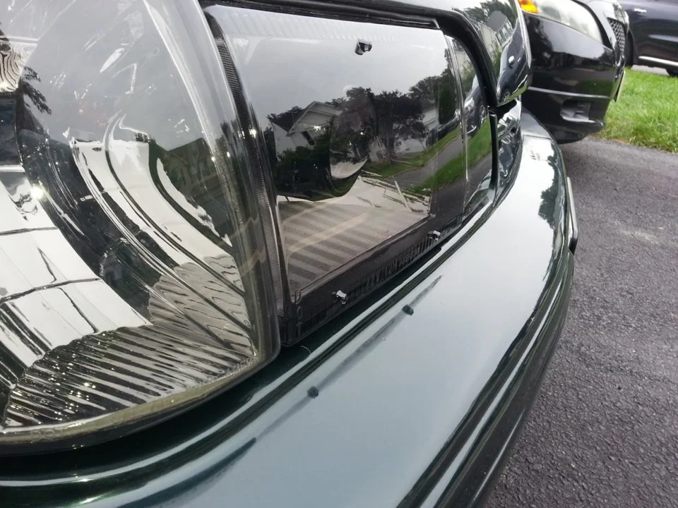

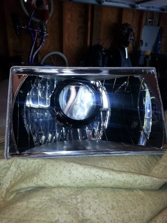

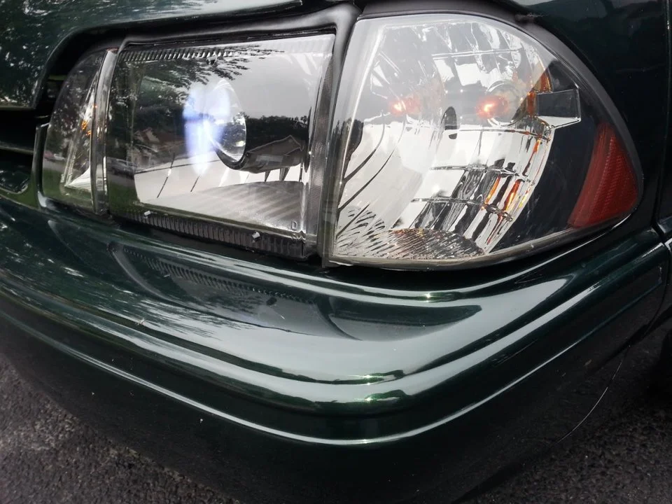

elarm1
Dec 17, 2010
1,428
652
154
N.Va
Aug 9, 2015
  • Aug 9, 2015
What I have is the Morimoto Mini H1 6.0 bought from TheRetrofitSource dot com @FoxMustangLvr . This is no cheesy setup that was jammed into a set of halogens. A lot of work went into unsealing, trimming, and installing these projectors into the set of headlights. These lights shine like a new cars lights and will out perform any set of Aftermarket headlights that you buy.It is not caulk surrounding the headlight, @from6to8 it is the stock trim piece. I wanted them to be discreet as possible so I modified a couple of parts to my liking. I had no negative affects with my kit and best of all, I can see NO PROBLEMS at night now. I couldn't say the same for my 25 year old headlight design. My safety is key so why not use the technology if it is here?!

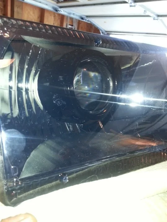

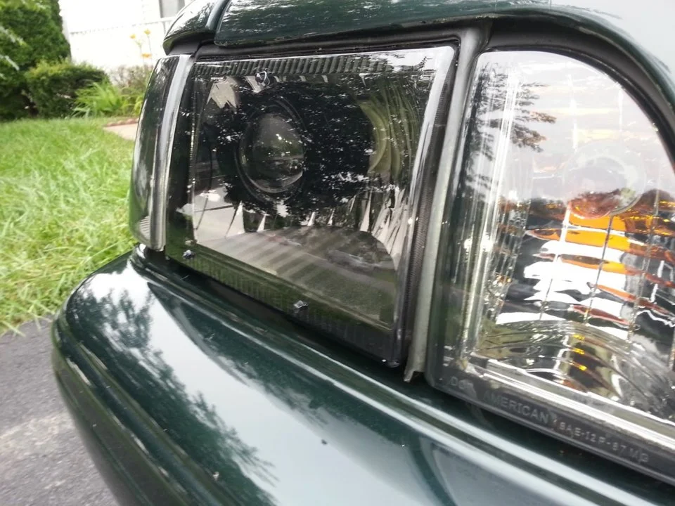

Aug 9, 2015
  • Aug 9, 2015
More pics. Don't mind my hood gap or my "caulking" or headlight trim. it all has since been fixed
looks great man. I haven't called them yet but will tomorrow. See I'm not going to want to do any mods after I get whatever I need from them so all of that will have to be discussed prior to me making a decision on getting from them or what. that's also why I want some good fog lamps to help out my headlights just in case I don't go the route you went.
What was the cost for them to do what they did for you and what all did they do?

@from6to8 They did nothing but provide me the parts. Work was done by me! Cost? Headlights, retrofit HIDS, HIDS, and all assosiated tools and small parts it was roughly 400 bucks.
oh ok. What all did parts came with what they gave you?

I just bought the Morimoto HID Retrofit kit that came with both projectors and its hardware and their HIDS which also came with their own hardware. All else I bought on my own and put together @from6to8
