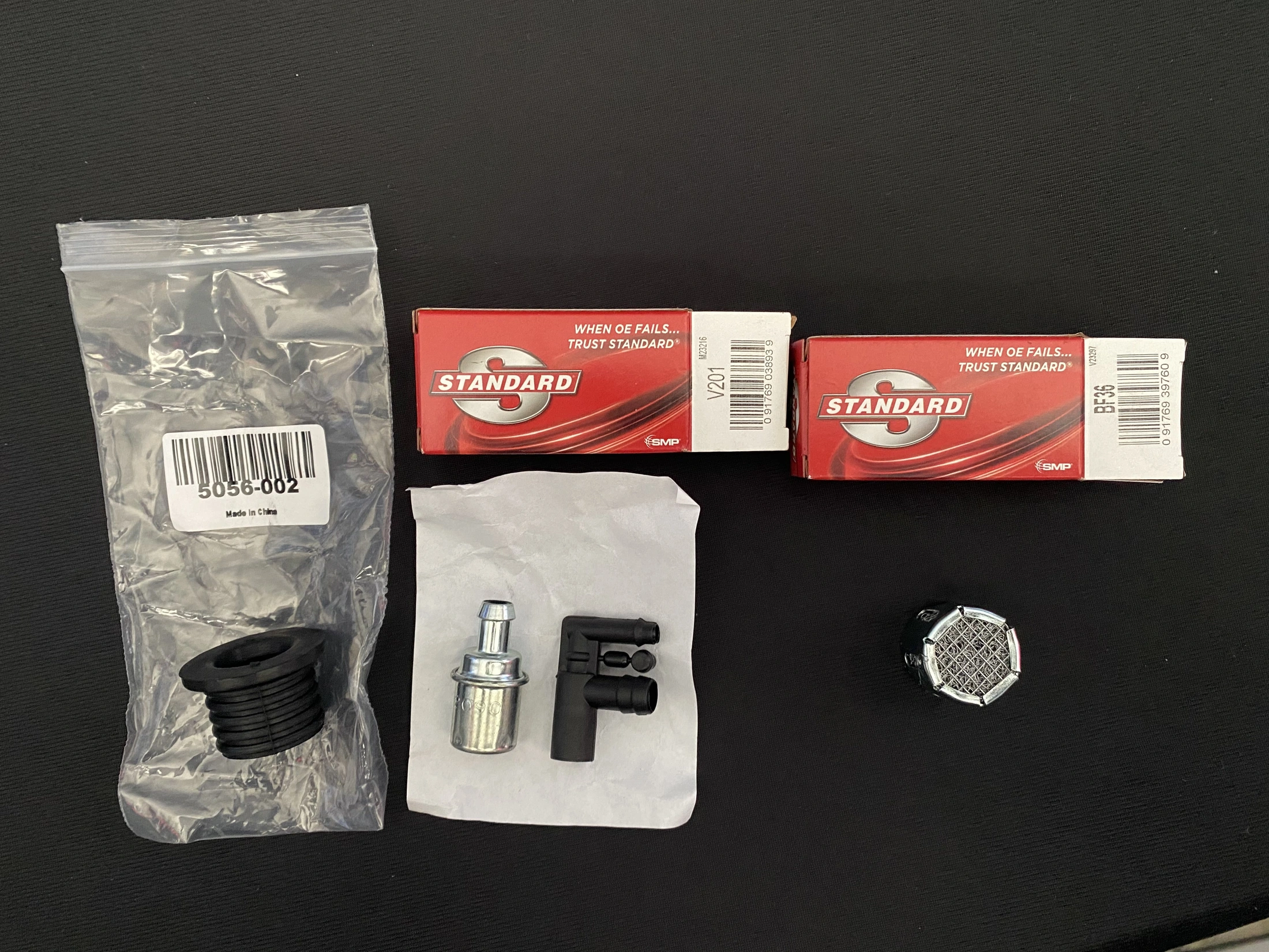

The brand “Standard” PCV valve part V201 comes with the vertical nipple that the fox hose can just push straight down onto. Disregard the “F” style connector that it comes with.
You would also want to replace the screen. Standard brand part BF36 and perhaps the rubber grommet while you’re at it.

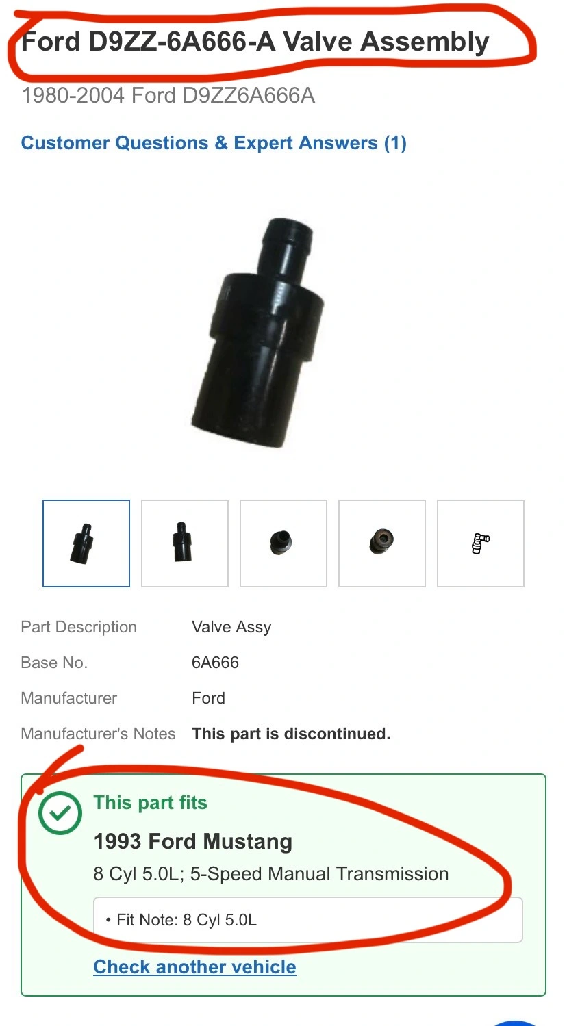

Been going down a small rabbit hole trying to figure out which would be the correct replacement from Motorcraft. So far I've found the following matches:
  • EV-98-B (Ford P/N D9ZZ-6A666-A, black, seen listed for 86-89))
  • EV-147 (Ford P/N F0ZZ-6A666-A, light gray, NPS lists is as for 90-93)
Looks like the light gray one would be the factory replacement. Could anyone confirm? Are there other part numbers that interchange?
As per Ford Parts Online:
Light gray (F0ZZ) is listed for the 2.3L.
Black (D9ZZ) is proper for your 93’ 5.0 (discontinued)
If you check RockAuto and look at the OEM part numbers that interchange for the 3 options they offer for your 1993, they all list the D9ZZ and not the F0ZZ part number. Same as on other parts source sights.
