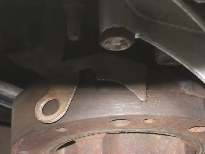

S svtpower New Member Apr 30, 2005 257 0 0 Wisconsin May 18, 2008 #1 May 18, 2008 #1 The circle on the left? One of the edges in the middle? The far right edge?
93 LX Founding Member Jun 2, 2000 3,081 3 0 Norwalk, CA. May 18, 2008 #2 May 18, 2008 #2 the pointy end
S svtpower New Member Apr 30, 2005 257 0 0 Wisconsin May 18, 2008 #3 May 18, 2008 #3 hmm OK, thanks... That's what I thought. It runs like crap when I time it at the point on the right though, backfires out the tailpipe, seems to run much better when I set timing in the center area..
HISSIN50 "How long does it take to get help in here? 15 Year Member Nov 29, 1999 31,179 34 129 May 18, 2008 #4 May 18, 2008 #4 Your balancer might have starter to separate.
93 LX Founding Member Jun 2, 2000 3,081 3 0 Norwalk, CA. May 18, 2008 #5 May 18, 2008 #5 +1 on the balancer
