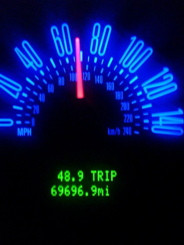

Have you tinkered around yet with "My Color"???? The first few nights I had the car, I must have spent 20 or so minutes playing around with different colors! I've now had a medium shade of blue for about two years now :nice:
I did mess around with it for a while after finding out I had it. The previous owner had a really cool shade of blue set that I used for a night. Problem is I'm a freak when it comes to uniformity so I've been using the green ever since.
:lol:
I hear ya, lost! I had it a green (reminded me of a Bullitt look) shade for a while, but eventually got tired of it. I now have a stereo screen that is blue, so that helps the transition:nice:
