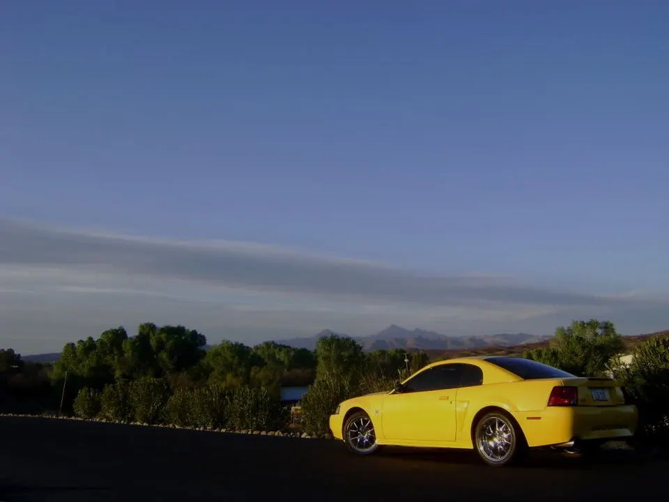

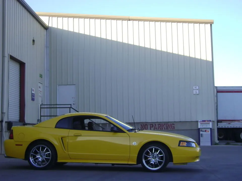

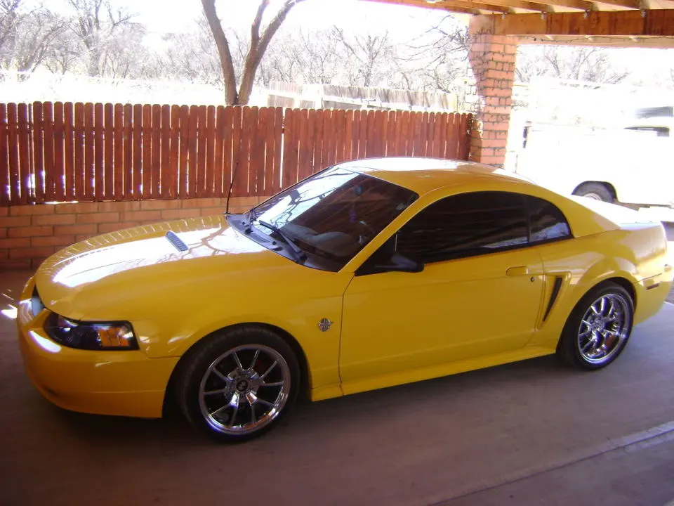

o, my bad i didnt read your sig
yea sure:
i miss it to no end

That colour and rim combo looks awesome!
