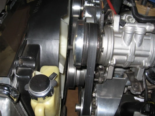

I don't think that the Volvo fan is going to work. I attempted to use a single Mark 8 fan and it hit the lower pulley. I have a Vortech w/ the extended front pulley, necessitating the use of a dual smaller fan.

Wish I had a pic of mine, but the pulley is about 1/2" from the stock shroud right now. I have a Griffin 2 core (1" cores ea) alum rad.

Thanks for all the responses. I have a pic showing my dilemma. I looked at the Spal fan and at close to $400 just for the fan, I have to say no to it. Going to see if I can get a closer up pic.

Brian, Thanks for chiming in. You may remember me as I bought the Mark 8 fan and controller from you 2 years ago and it didn't fit. You stepped up to the plate and hit a homer IMO w/ your CS. Thanks. Am now ready to do it again as fan clutch finally took a dump. As you can see by my pic, I'm extremely limited w/ space. What fan is yours from? Looks like it may be a SVT Contour fan. I have ordered the controller, (not yet received) but may consider your fan/controller if the price is right. I think I may need to do more measuring though. Any thoughts?
