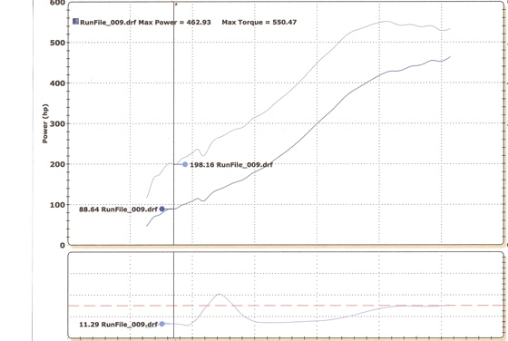

all I can tell you is that on 14lbs with a H1E off a backhoe, 120k mile stock 5.0 shortblock, home ported e7s, weiand x-celerator, f-cam, t5, 1 5/8" shorty hedmans and a 3.5" downpipe it made 505rwhp at 5700 and 550rwtq at 3600.
I never took off the final dyno sheet but heres the one I used to set up a few grudge races:
it was like the 3rd pull we made on it and you can tell it was a long way from being tuned right. We ended up making probably 7-8 pulls after this one . . .
so whatever calculations you need to do to make that work . . . I am just telling you what I did. :shrug:
