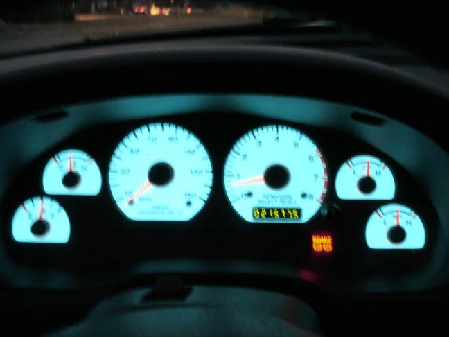

My $25 ebay special overlays
Sorry for the blurry shot, but you get the idea
I love em. Had em almost 3 years now. My friends like em too.
They come with a dimmer, so i usually run them around 50% lit. When they are dimmed down slightly they have a cool eerie look to them. The photo above is full brightness.

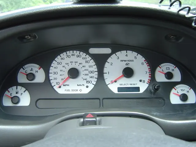

The one white cluster looks like the UPRs I have, 1 piece and a slight blue/sea green tint.
