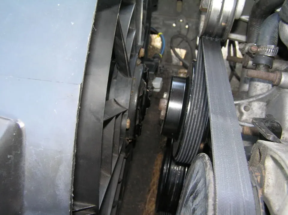

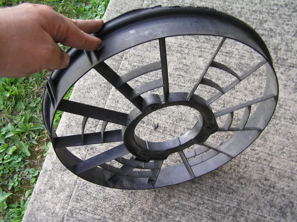

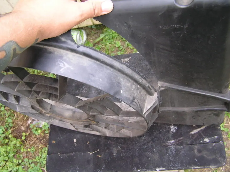

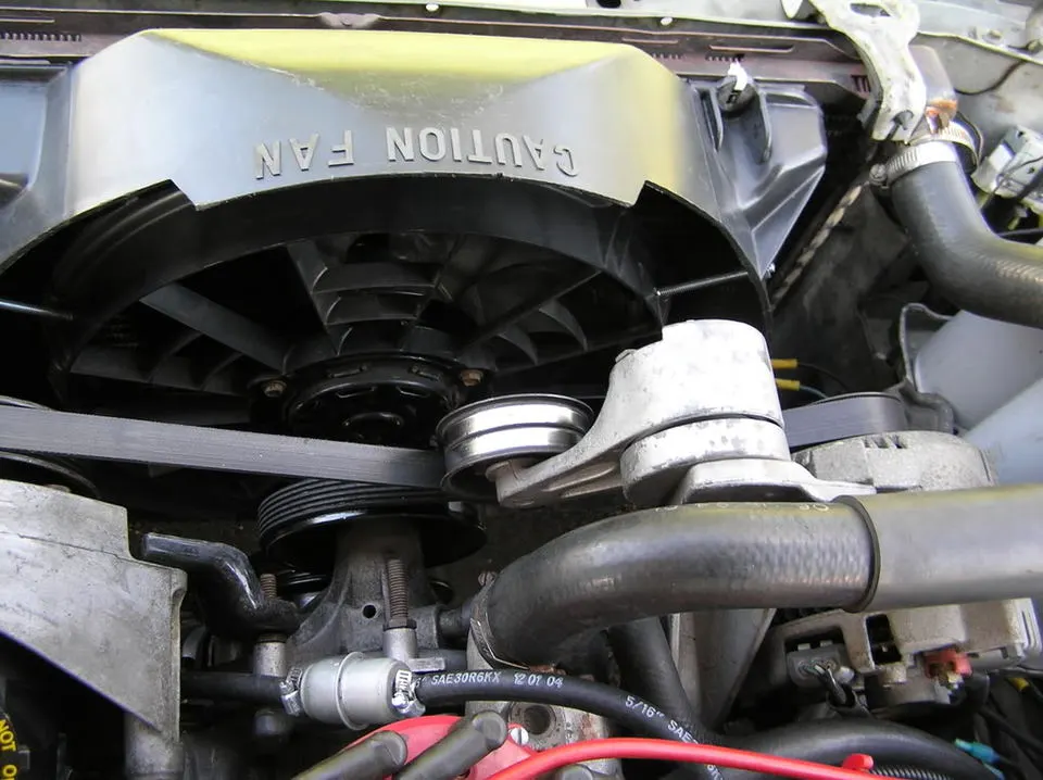

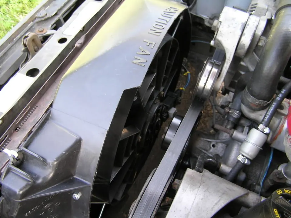

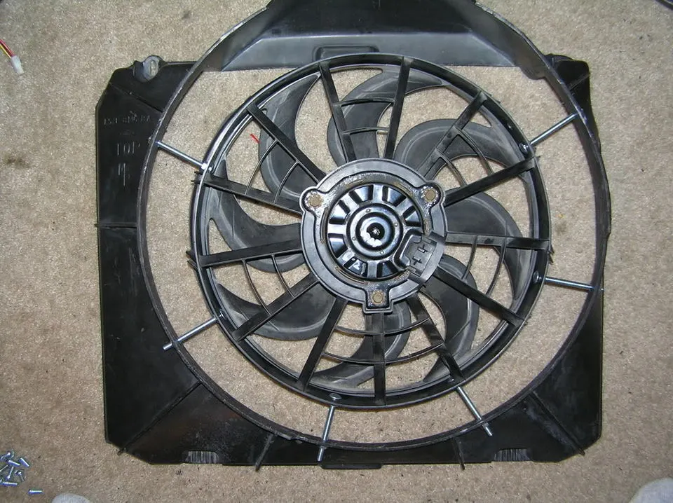

The thread is still in Tech...it's pretty simple. You just cut out the circle portion of the fan and suspend it inside the shroud. Make sure you test fit it and get an idea of how "deep" you can go with the fan inside the shroud so that 1) the blades don't hit the radiator and 2) the fan motor clears the water pump pulley.
Sadly i don't think the Lincoln Mark VIII fan is going to work...or at least it was going to take more modification to get it to fit inside the shroud, so the setup works best with the Taurus fan.
Here's pics:
