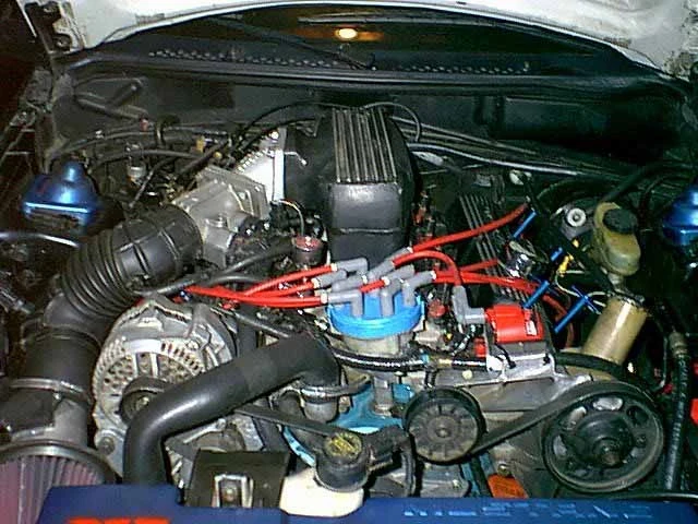

Ok here is the best bet to fit under the stock hood, no guarantee's but it may work as you can tell in this pic. You WILL have to run a box upper intake which will kill your torque down low, however it MAY fit. The only problem area I would be concerned with is the front of the intake, it may not clear. I had a Performer intake on for awhile until I got my other parts and that intake still rubbed on my Cobra RR hood!! I have pics from the side of the car etc with the old intake on it but I will have to scrounge them up....
i just sent the pics to idiot5.0, he said he would post them for me, there is a side shot in there so you can see how tall it is. sorry the engine is so dirty, i haven't had much time to clean it lately.
