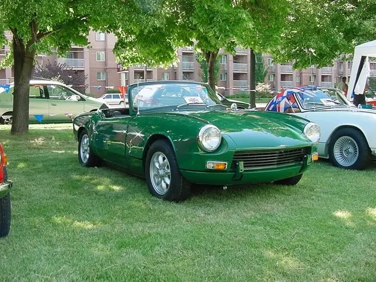

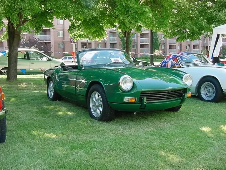

It's not a Mustang but I did paint my other little car. I used a 5 hp, 14 SCFM, 80 gallon receiver compressor that I bought from Harbor Freight, US Genreal brand, I think. Still have it and it still works great. I used a DeVillbis Finishline II HVLP sprayer. I manually sanded the whole car (hard work) before paint and manually color sanded it after paint (harder work).
Here's a pic of the final product.

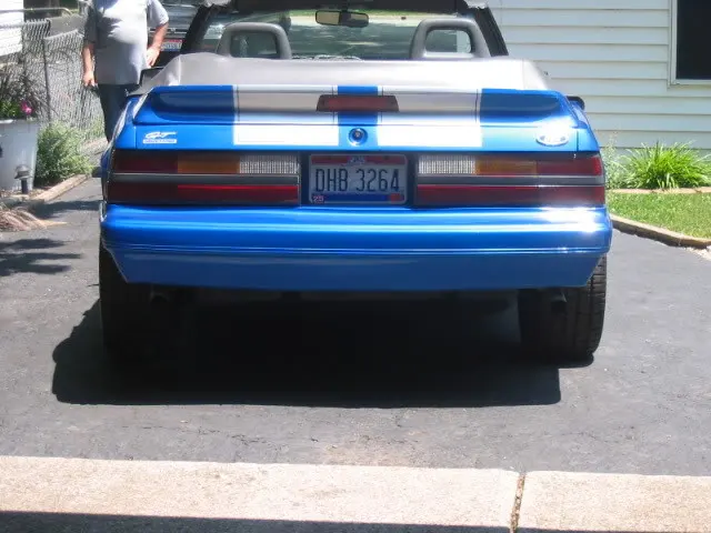

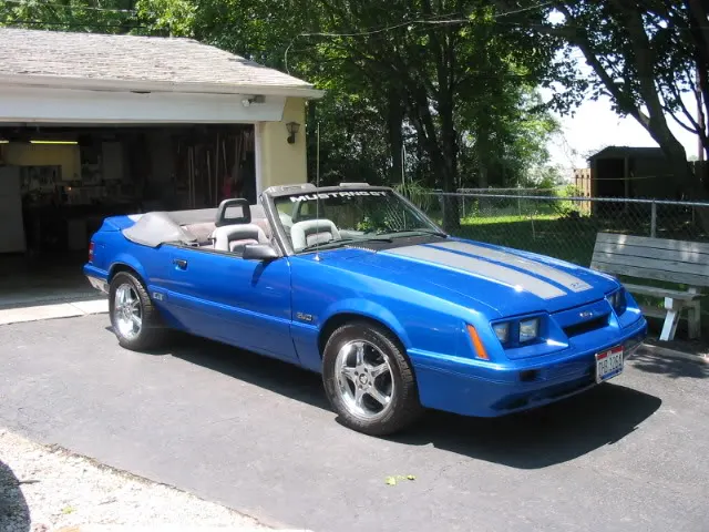

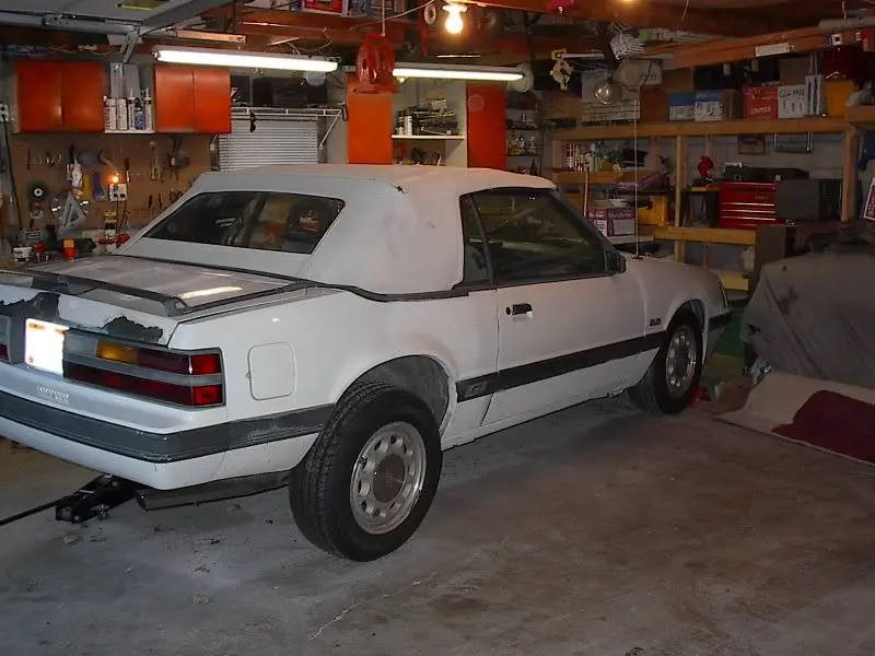

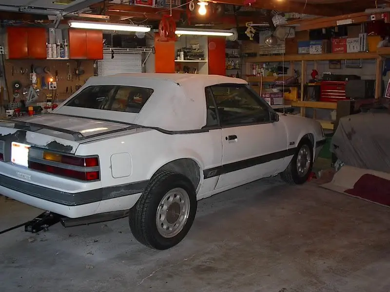

I painted my previous 86 GT..
I used Dupont Chromabase stuff. I signed up for auto-body repair at the local tech school and used their air and tools, plus booth. Basically just like most body shop booths expect one wall was glass, so it people could watch for a class. Tell ya what,, I see why a good painter charge's so much.. The key is in th eprep work.. The more you out into prep the better the job..!!
1st I DA'd the car with 180 done past the factory clear, then did body work. Filled in minor dings and emblem holes and such. Primed the car with a Nason Euro-based primer( 3 coats). Wet sanded it with 500 grit and sprayed 3 coats of white base, then 3 coats of Duponts 7900 clear.
I also painted a 93 vert for a friend using the same method....

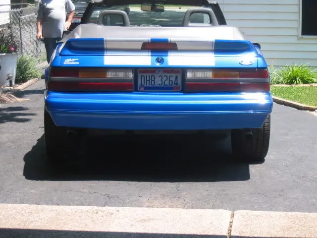

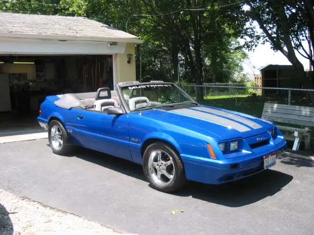

Here are picture of my 86 top GT and th e93 vert I did while in school....
86 when I started...
After I painted it...
The 93 vert I painted....
