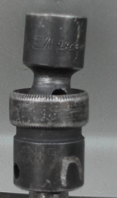

Here's the tools I could not do without.

thanks for all the responses. It doesn't sound all that hard so I think that I will attempt it. I have a buddy and a tranny jack so that won't be a prob. I even have the 3 foot extension and all the wobbly head sockets starting at 3/8 going to 7/8 including the metric. With the throwout bearing and pilot bearing, are they easy to remove? Don't they usually come in a clutch kit? Any other parts I should change while it is apart? Does Ford sell service manuals for the mustang that identify all the necessary torque specs for the car?
