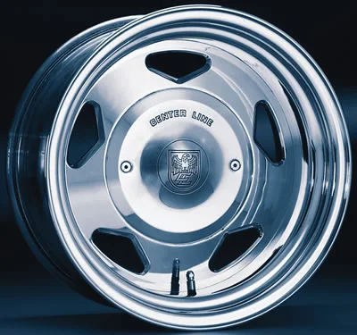

btw, hes sellin a badass set of polished centerline rims in awesome condition w/ almost new tires (225-50-15 and BFG's i think) for only $300. they are a 4 lug pattern for the stang. they look like these. if anybody wants them, i could hook them up w/ them for $300.
