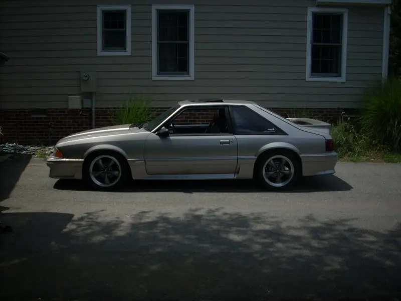

1994-95 gt/v6 spindles, calipers, rotors, pads, hoses, and then sn95 balljoints, or a .330 spacer, and the weather head fitting (4 bucks) that can be bought on latemodel or maximums site to fit the passenger hose to the stock fox line.
thats what im running, pedal feel is a little softer but not too bad.
