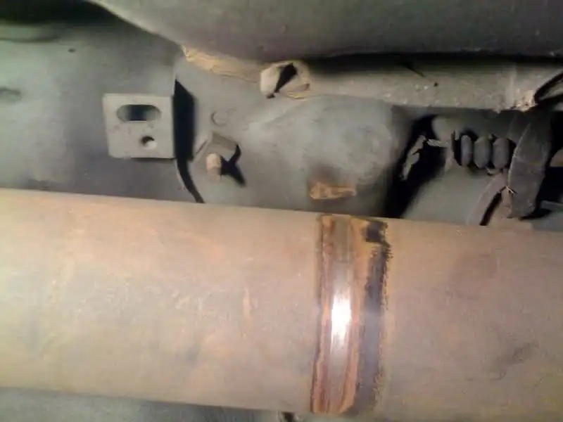

It's definitely rubbing along pretty much the whole length of the tunnel. I saw the scrape marks on both the tunnel and the driveshaft. The tunnel has little grooves and ghats where it's rubbing. So it'll rub in one spot and then about two feet or so there's another spot where it rubs.
You can see the rubbing on the driveshaft. Has anyone else ever had this?

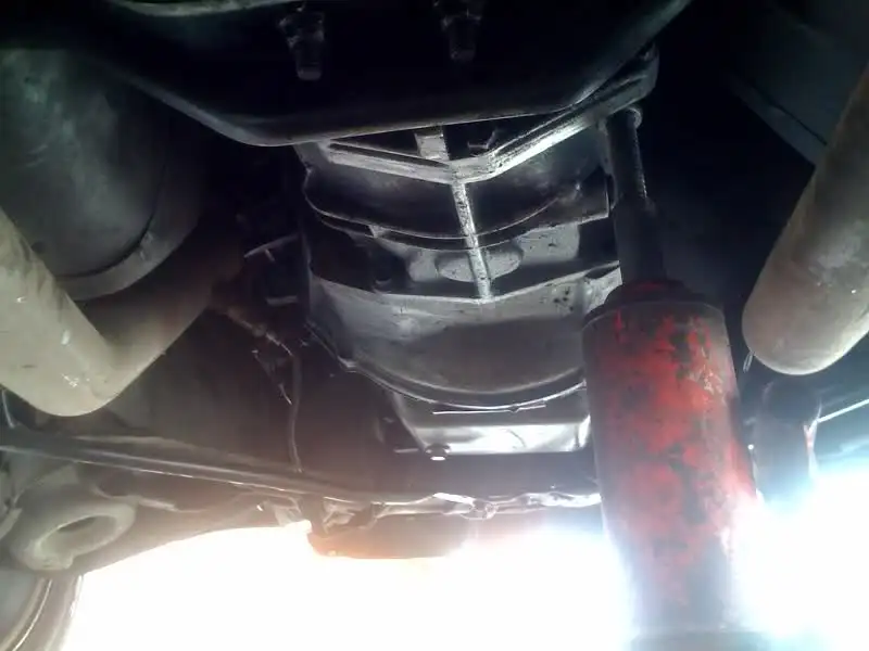

We tried putting that bolt into the transmission mount, but we couldn't get it to align. My transmission seems to be crookedly aligned and gets in the way of the trans mount. I pretty much hate the previous owner right now for such sloppy maintenance on this car. Worn out bolts, missing bolts, oil ALL OVER the underside...
That damn bolt was being a pain to find...and it just so happened that my grandfather picked up a random bolt at the pick your part and it fit... -_- although it's longer than the OEM one.
Oh well, we'll try again tomorrow with some more time.

I think your pinion angle is way off, could be a few things, like the motor mounts sit too high, the trans mount is too high, or for some reason your rear has the pinion side angled upwards.
Here is the pic from the side of the car:
And here is the transmission:
We were using that jack to try and tilt the transmission up from the right side and see if we could slide the mount into place.
