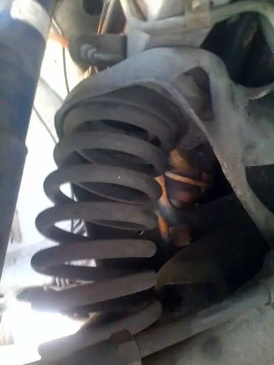

Whose fault is it? Rear control arms or springs?

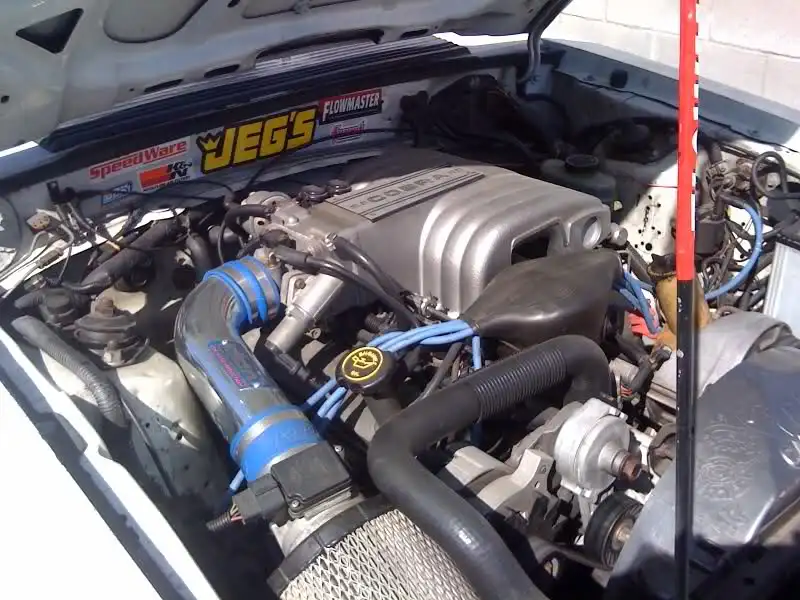

Also will this filter be a direct swap to the one I currently have?
change to
BBK High Performance Cold Air Intake Replacement Filter (86-95 5.0 V8) at AmericanMuscle.com - Free Shipping!

I'm feeling very noobish for having to ask this...but... do our cars come stock with the springs all by themselves like this?
Or should they have anything going between them? I guess I should know but I really don't know jack about suspension. All I know is how to replace shocks lol... what should the suspension setup on my car look like? Anyone got pictures and an explanation?
Sorry about all the noobishness and questions. I have a lot to learn!

You can also check to see if your car has the proper suspension travel limiters, which are essentially rubber stoppers that prevent the suspension from actually bottoming out at each wheel. You can locate them by common sense. If nothing is found, they may have been lost/removed.

I had another look under the car. While underneath it, I noticed 2 things:
1. My driver's side upper control arm is broken.
2. Both lower control arms are missing bushings.
Does the broken upper control arm have anything to do with letting the driveshaft lift thereby rubbing the body?
What are the effects of missing bushings?
Thanks.

So I guess I'm in the market for a new set of control arms. Will I be good with the cheap no brand control arm kit from either AmericanMuscle or Latemodelrestoration? Or is it more than worth the extra money for a better quality set? If so, any suggestions? What is the difference between tubular and boxed?
I'm also thinking the UPR chrome moly ones.

Yeah, I think I mentioned that back on November 11.
Maryland Stang said:
Take it back and have them inspect the rear closely. There's no way you can have that much damage to the motor and tranny mounts and not have blown out rear bushings. A lot of shops won't even look at them because they can be difficult to replace.
The broken arm and missing bushings will allow the rearend to move around. If it does it excessively you will feel it and could possibly loose control of the car especially on wet roads.
At this point I'm am going to extremely recommend you take the car to a Mustang shop and have it inspected. If it has a broken control arm the chances are high that there is torque box damage and you have proven that you don't really know what to look for since it took you 6 weeks to notice a broken control arm and missing bushings.
YOUR CAR IS NOT SAFE TO DRIVE
yea pretty much what he said... my suggestion is DMP out there Dante is more known for his Lightning work but im sure he could handle a fox...
