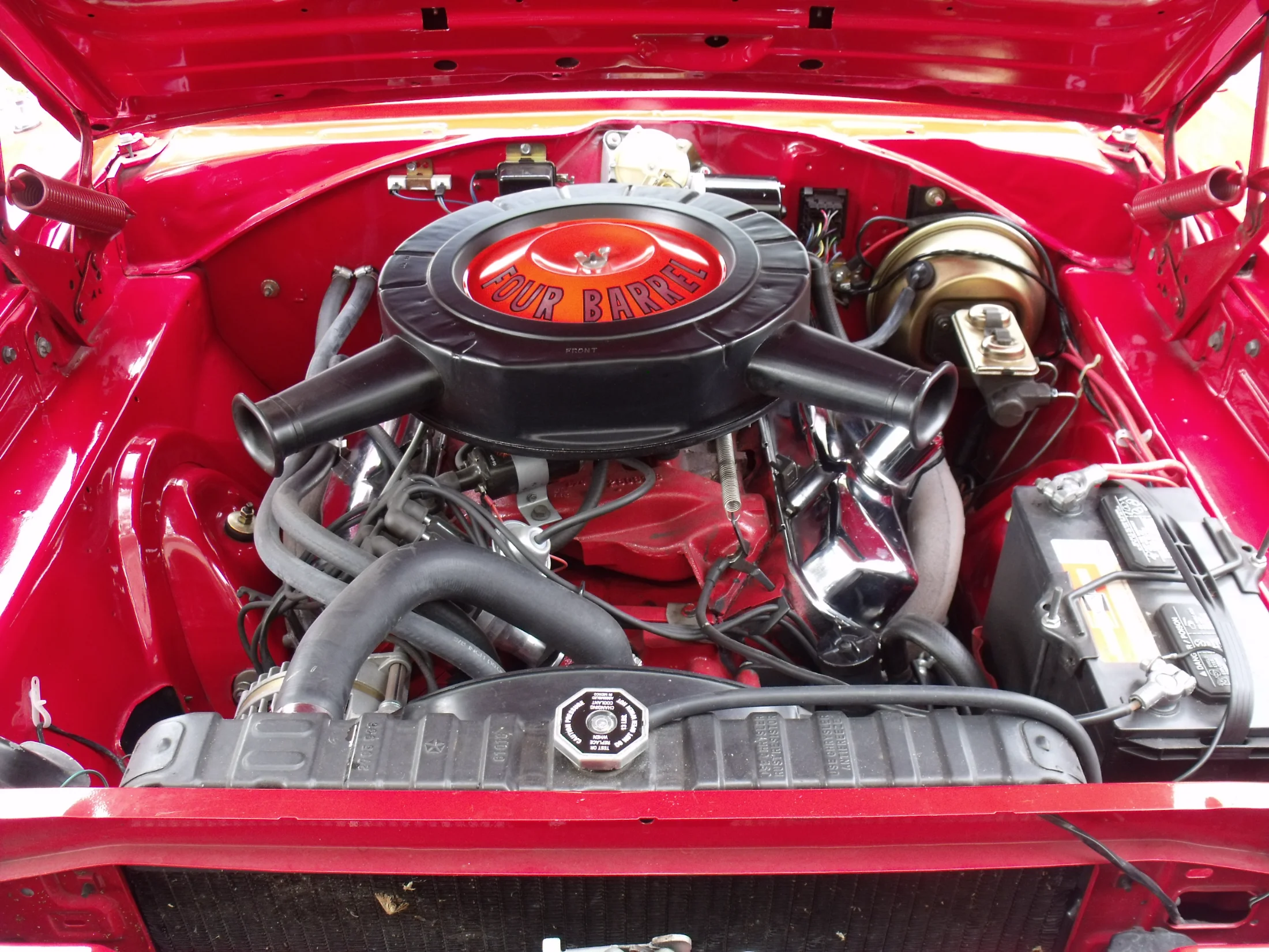

My old boss was a national record holder back in the 70s bracket racing
He was always talking about weight transfer, course he had an old Chrysler Hemi and heavy 440's
Are you fast enough to pull the front wheels?
Finally got some 4.56's in my 69 and I can pull the front wheels now but it's still a slow schlep
