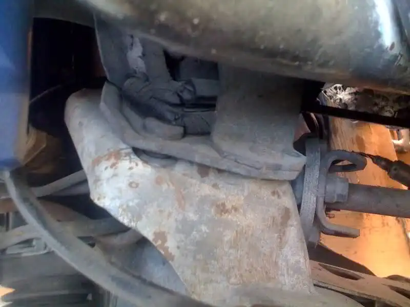

Yeah it was missing one of the two that bolt the trans mount. These ones:

They're just bolts. You can replace them with any Grade 8 bolt and you'll be fine. Yeah, that tranny is not supposed to be crooked like that and that's why it's hitting. Like everybody is saying, put new tranny and motor mounts in it and you'll be fine.
I'm going to give you a little more advice because I think it's appropriate given the apparent condition of your car. Take the car to a respected front end alignment shop and have them inspect the entire suspension, front and rear. I'd tell you to do it yourself but I don't think you have the knowledge or experience to ensure your own safety in this area. I suspect you're going to find a lot of blown out bushings, bad struts and shocks and possibly worn steering linkage.

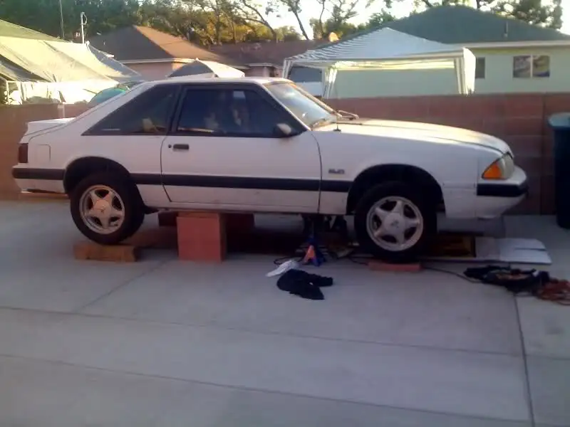

Update: I finally got another look under the car. Last time the limited space under there made it difficult to move around. So this time I put it up on blocks...it seemed pretty safe.
So with the new ground clearance I went ahead and jacked up the transmission, slid the mount into place, and put in the first bolt, which went in just fine. The next one was a little different (longer and probably smaller spiral). I put that one in and it seemed to be going in just fine until the end where it seemed to pop out. So I decided that I'm just going to get the exact bolt I need to make sure it's done right. If for any reason the spiral is worn out then I'm just going to use a lugnut to keep it in place.

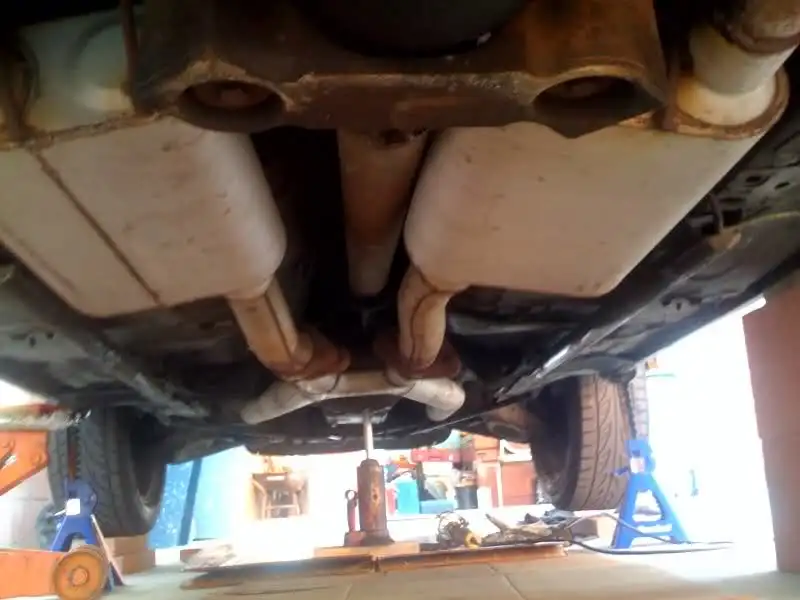

It seems that my exhaust pipes are also almost touching with the driveshaft:
From the picture it sort of looks like the driveshaft itself is out of place, but that's probably just the picture's angle. The passenger side of the muffler is closer to the center of the car. I don't think that's giving me any issues, though.

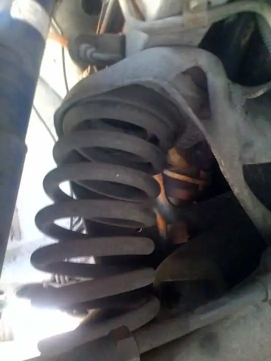

I also checked my springs. Is it good for them to be bent like this, even while the car is lifted all the way? Would anyone say, "Those need to be replaced." I'm just looking for a justification lol... to spend the $220 for some Eibach Pro-kits as a Christmas gift to myself.
