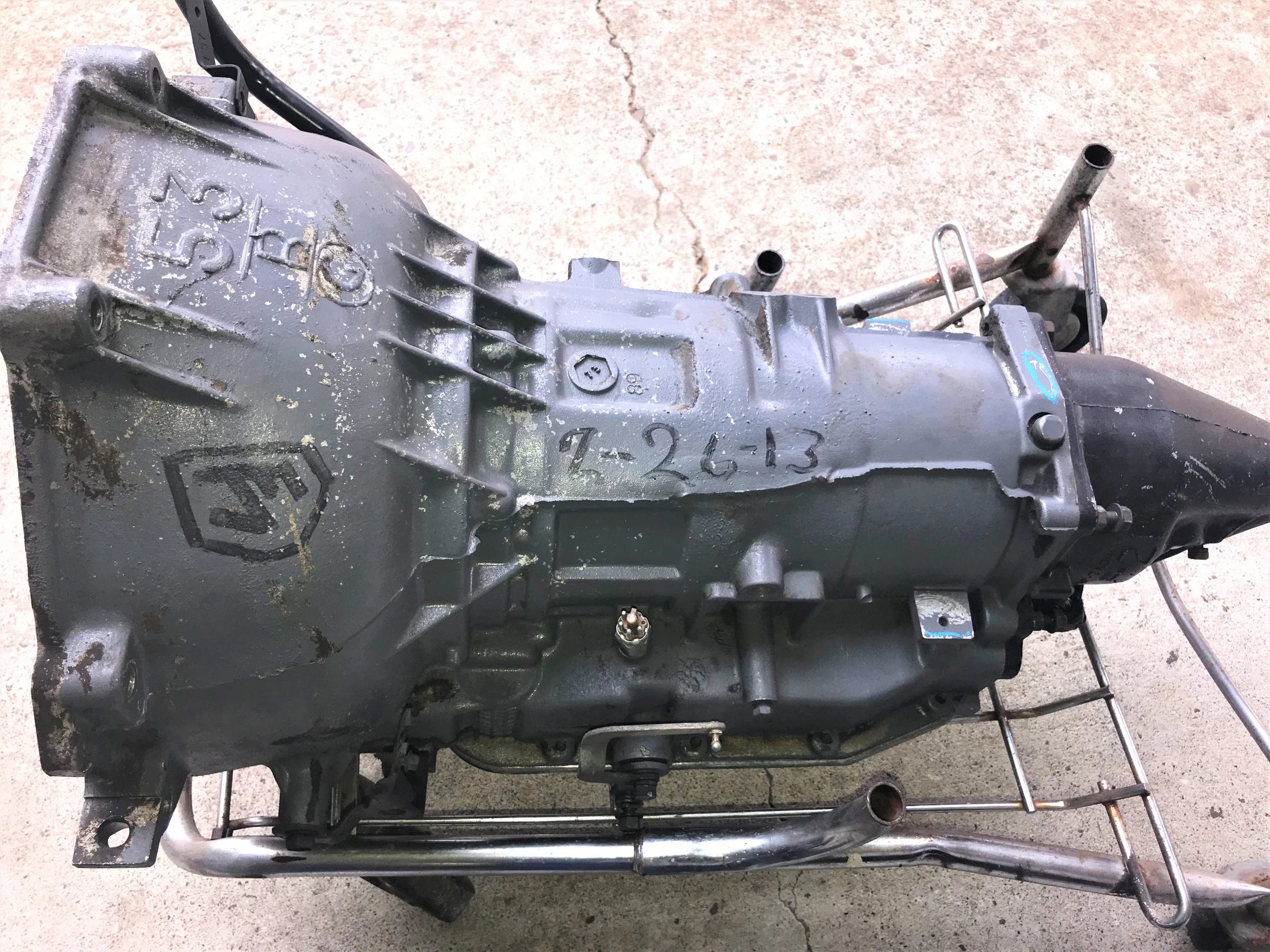

That's the best I can describe it! It's silent in park and neutral but as soon as I drop it into any gear it makes the 'whirring' sound. Noticeable at idle but can't really hear it while driving because of the exhaust tone. Drivetrain out of a '93 Mustang. All I did was drain and install Motorcraft Mercon V trans fluid, filter and new trans pan. Didn't see any metal shavings in the pan when I changed fluid. Checking trans fluid, it's right where it needs to be on the dipstick. Not sure if the trans is original cuz of the 7/26/13 markings on it. Anyone have any ideas?

With the date scribed on the case, I have to wonder if Kevlar clutch packs were installed during a rebuild. If so, it would explain the whine ( at least, in my head. lol ).
