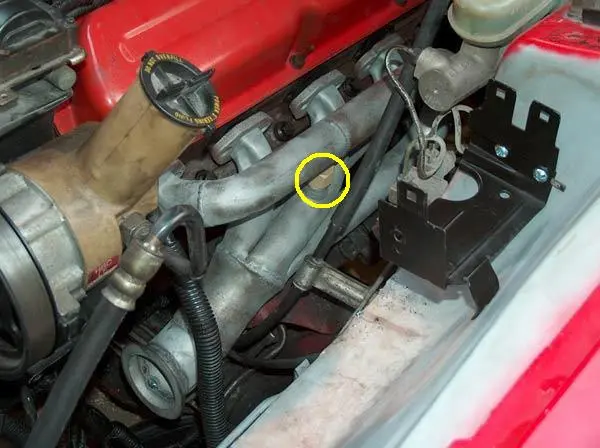

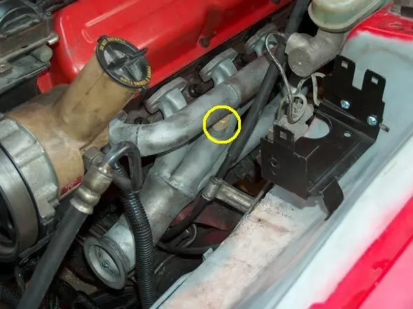

Chris, we mocked up your kit on my car tonight and it looked great. Is your car a manual or auto? Here are a few pictures I took when we had it on my car... I just wonder what happened to my LT's that were on there a few days ago

sweet! many thanks to 1105 for providing a car for the mock-up.
it is a manual. one question tho ... just curious, what is this?

BlackVert said:
sweet! it is a manual. one question tho ... just curious, what is this?
if that was the passenger long tube, i think its the egr tube.
edit: where the egr tube meets the header.....same thing
BlackVert
Oct 3, 2003
5,589
9
98
Bethesda, MD
May 24, 2005
#100
  • May 24, 2005
  • #100
it is a driver's side header for a single turbo setup.
