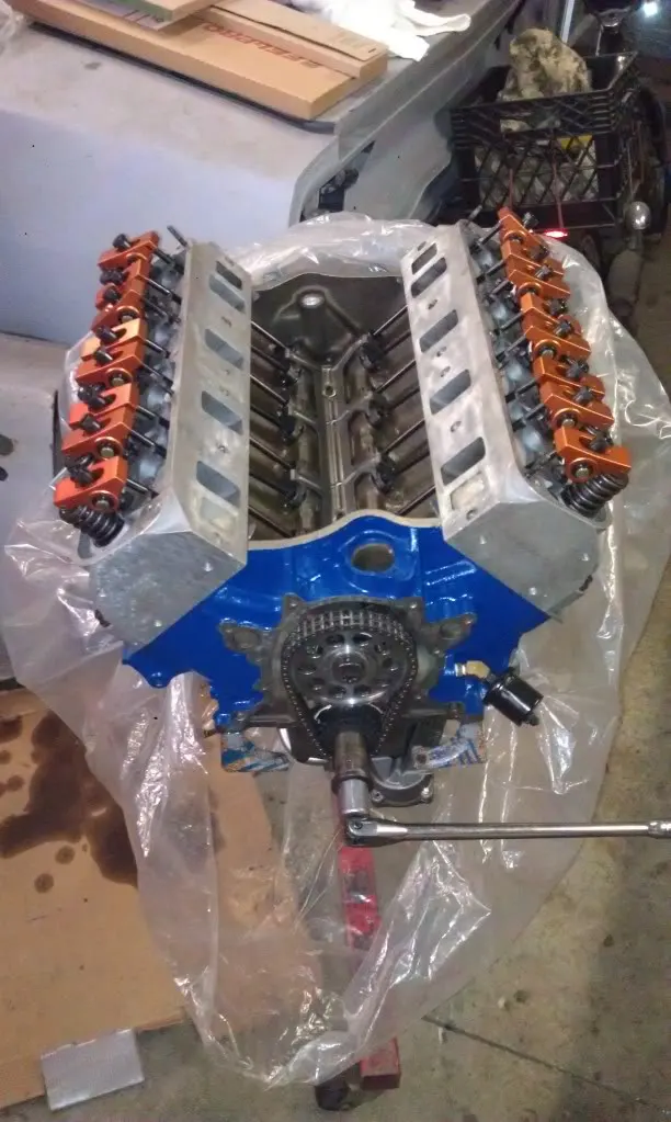

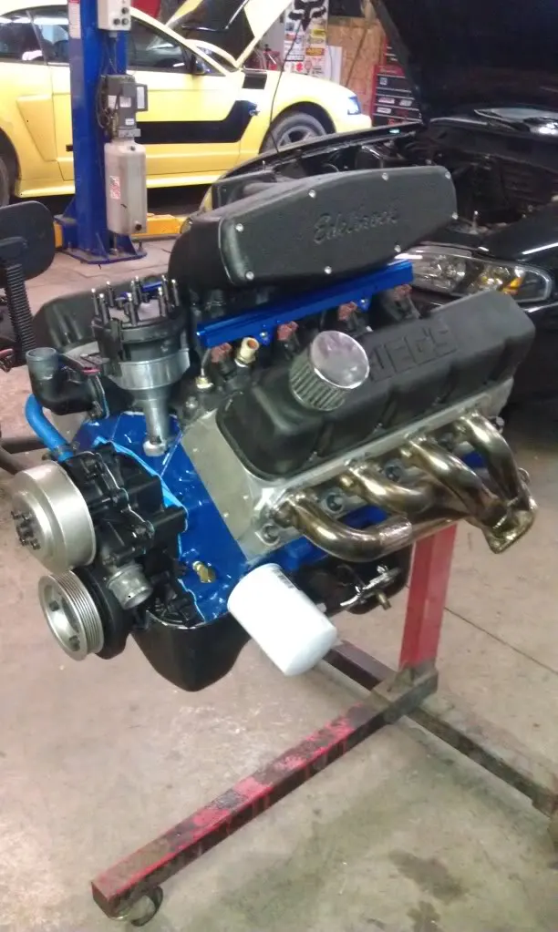

331 > 347. Small vortech, lots of MM stuff, you'll be fine. Basically my car, and it made 370 rwhp n/a, and over 550 rwhp boosted on 12 lbs.
I also have koni yellow coilovers all round, griggs tubular stuff, lots of MM, etc.. car is a blast.. edit: +1 on quarterhorse. Have one and love it.
AFR 185's, nice crane cam, Edelbrock RPM intakes, stock block 331, shaved/balanced crank, 1500g bob weight, Mahle phosphate coated flat top forged pistons/phosphate coated rings, 90mm maf, 42's, s trim @ 12 lbs, etc.. standard setup, shorty headers, offroad x, magnaflows.. no smog/ac.
Standard, tried and true setup for 2+ decades, now. Add a good suspension and brakes and it's more than enough to get in trouble with and blow off the occasional supercar with a doucher behind the wheel
